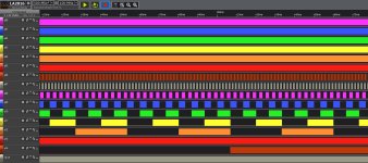

Watching the address lines on the rom bios with a logic analyzer, along with the /chip enable and /output enable, I can see the bios start to kick in with a first read from FFF0 (7FF0 in the 32k rom image) then to the next instructions after the JMP that it finds there. This proves that my address capture methodology is correct. (have used it on a 16bit data bus machine / 286, not an 8088)
I can then see it doing what looks like a memory check (address lines counting up in a sequential pattern.
After that the bios goes into a loop that appears to be retrying some operation. The bad news is the thing won't start up, but the good news is that is is stuck in the BIOS code, so if I can disassemble this BIOS ROM I can follow the path it takes through the code and find where it is looping (what what condition is required to exit that loop)

The address tracing shows that the system appears to be performing multiple different kinds of memory tests even several seconds after the 'Testing Memory" message goes away.
Maybe I'm just giving up too soon? How long do other people's 171s take to test memory, and how much memory do you have?
Mine is configured for 640k, and I've been giving up about 10 seconds after the 'Testing memory' message goes away.
The LA trace that I have shows that at the beginning it performs a rapid test where it accesses all memory addresses sequentially. lasting about a second, then it goes into a longer cycle of testing that seems to still be under way 5 seconds after the message goes away. The trace shows both BIOS ROM addresses and memory addresses so I can see that a few different parts of BIOS code perform different aspects of the memory test. I'm currently working on identifying the parts of BIOS code that performs the different tests and the memory ranges that are tested by each. Hopefully that call tell me if the memory test is progressing and just being slow, or stuck.
Example of apparent memory test attached (although the a13 line looks wrong, I'll have to verify the connection to the pin and test again)

My machine takes maybe 10sec to complete memory trst and move on.
I'm your case it is surely moving on to the world map screen. BOOT key should enable boot from floppy.
Yes a13 looks suspicious. Might want to spend some time with that.
