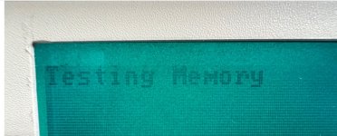

Continuing this diagnosis, I've found a couple of interesting things using the LA on the 8088 pins.
The 8088 is running in max mode, so I can use the state pins S0/S1/S2 to tell the difference between IO Write, Mem Read etc. One of those states is "Halt". That's where we get to right as all the address/data activity stops. Only the clock signal remains in an active state.
However, the cursor (which is a square rather than underline style cursor) still flashes. That tells me that the screen refresh still works.
By watching and decoding the data lines during the memory test I can tell that the test on screen is being refreshed with ascii values (not pixel values post-chararcter-rom). So the system is definitely still fully active while testing memory. Curiously the screen is drawn in reverse, so parsing the decoded lines shows ascii "<y> <r> <o> <m> <e> <m> < > <g> <i> <n> <t> <s> <e> <T>" being drawn do the screen repeatedly. An observation, not a significant finding for diagnosis.
I also reduced the memory from 640 to 256 by adjusting the jumpers, and the mem test now completes more quickly. It still halts immediately after with the same LA output, but it's a reassurance that the memory is actually being tested and is passing (removing a chip that is expects to be there causes it to display an error/address) . That also allows for easier timing of running the LA to capture the halt.

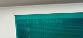

I got the thing to sort of boot...
Long story short... Attaching my LA to the 8 data pins on the PPI resulted in a change to the bootup behavior.
Previously I would get a "Testing Memory" message for a few seconds, then the message would be replaced with a flashing black cursor and the CPU going into HALT (Per S0/S1/S2 status).
With the LA hooked up to the data pins on the 8255 and the ground on the CPU the behavior is now that I get a permanent beep after the "Testing Memory" message disappears, and I now get a new message to the effect of "Timer Interupt Failure", then after a few seconds the world maps shows up.
This worked in this status for a while as I tried to document the testing condition. It was intermittent, and after a few minutes it went back to the old behavior.
