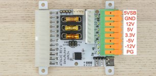

Greetings from Madrid, Spain. I bought a Zenith TurboSport 386 in mint good condition but I don't have the power supply to check this computer. Is there a way to buy any? Or at least the pinout of each of the 6 pins?
Yes, thanks. I downloaded the whole manual (over 500 pages) but it makes no mention of the power supply pinout. I only know that it works with two voltages, one for battery charge and one for computer operation. I think it's going to be difficult to see anything from the Zenith, it's a rare and very minority model.
I'm on vacation right now, but can get you the pin out when I'm back. Just remind me after the 14th. I have a working adapter I can put my multimeter on.
Thank you very much, knowing the pinout is a great step forward.
I have an adapter made by a british guy to use a standard ATX power supply on a vintage computer. I've already used it on an old Olivetti 80286 with the PSU died, maybe I can rescue the Zenith as well. I attach the adapter, a great invention that makes things easier, especially for people with little knowledge of electronics.

First of all, sorry for my English, it is another pending subject to improve.
I am very grateful to you for your very complete response. The first thing I will do is disassemble to see the condition of the capacitors. If I see that they are in good condition, then I will try to find a charger, with the specifications that you have kindly provided me with, and then it will be a matter of luck. My knowledge of electronics is limited and if the issue becomes very complicated, I don't think I will be able to solve it.
The truth is that they are very nice machines and I would love to see them in operation like other machines that I have rescued (an IBM PS/2 8086, an Olivetti PCS 286 and a Siemens-Nixdorf 80486). That way I would have a computer of each kind, I'm sure my wife doesn't think the same.
