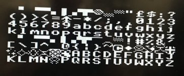

I have some news about my experiments involving the CHR$128 modification.
I was having some issues with timing, so I reworked the whole logic according to the new shift register cycle timing signals controlling the ZX81 registers, and after changing to a different internal signal to generate INVERT, I was able to achieve full support for CHR$128.
So that is great news in terms of how many games with cooler graphics will be supported on the resulting ZX81.
I tested with the "Alien Attack" game, and this is now showing the whole character set correctly in CHR$128 mode.

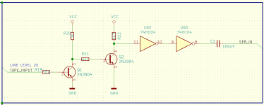

Next thing requiring some attention was the tape loading input.
I want to be able to use line level audio (around 2V amplitude) to load programs from a phone or PC headphone output.
These outputs can't reach 5V or even near it so I decided to experiment with a few transistos and fed the output of the circuit through two stages of the 74HC04 which is there on the PCB anyway. Feeding their output into the CPLD input through a capacitor of 100nF resulted in really reliable tape loading with minimal need to tune the audio levels so precisely. The amplitude of the CMOS 74HC04 output is really looking good showing 5V peek to peek pulses. Previously I also worked on tape inputs without having a scope, so this time I spent a little more attention to the levels etc. I am sure the circuits can be done in many other ways anyway I am going with this method because it is working well for me without any issues. The circuit between the tape input and the CPLD also can protect it from getting damaged by over driving from an external input of "unclear" levels, be it AC or DC. Using line levels is more safe and convenient in a modern use in my opinion. Usually we will generate some tape input using a modern PC or phone.
In attachment also the CHR$128 compatible version of the ZX81 CPLD, using all the new signals for the video / character timing.
