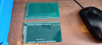

Heh I made an 80-pin carrier board for an Arduino Mega2560 if you'd like to try it. I'll have to dig up the design files; I think I included a SIP header for this uSD card adapter https://www.pololu.com/product/2587 I recall the purpose of this abomination was to have enough GPIO to monitor all the bus signals, while preserving the ability to serve as a Pony processor to aid in bootstrapping a ROM-less system.
