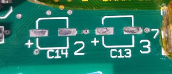

To the OP, here is what we're referring to. These are SMD capacitors that I am replacing on an LC system. The first is a picture of the capacitors prior to removal. There is some faint traces of corrosion on the right leg of C13 (the silver tab right above the three, sorry it's not clear the picture was taken to focus on the top of the capacitor and not the logic board itself) and none visible for C14. The second picture is the mess that was found after removing the capacitors. As you can see both had leaked but kept it hidden well. The third is the same area after cleaning. If you look closely at the solder pads for C13 you'll see they have been damaged from the capacitor leaking (they should be smooth like the pads for C14).
