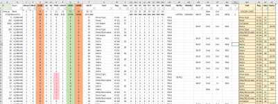

Yes, you can use e.g. a logic analyzer, I use the Saleae logic 16 type, it is great. But it is very difficult to extract only the relevant bus signals. So I have developed a very special one with 32 signals and does only trigger and store datas if relevant bus signals changed. It does store 50000 events and does copy these datas on the SD-Card. These events are then copied to an excel sheet, where it can easily be investigated.
This is the Teensy Logger Board
and this is an example of a XTA2SD card booting

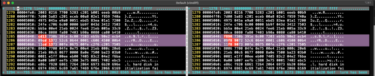

So, I was able to get an XTA2SD to function on a Tandy 1110HD with a big caveat. I couldn't get it working without patching the BIOS. Thankfully, both 1110HDs that I have use a socketed ROM of the AM27c256 variety (32k). Jameco had a few available still when I looked. I spent a few days digging around in the ROM with Ghidra trying to figure out what was going on. (I plan to do a more detailed write up on this soon.) There are three int 13h calls in the bios during the hdd process startup functions ah=10h, 09h, 11h called in that order. I haven't figured out exactly what those commands are sending to the drive but they all fail. Disabling (replacing the INT 13h call with CLC, NOP) them let's the XTA2SD just work, I was actually started when the machine booted out of the blue on me. That said, this approach is not for the faint of heart, requires expertise patching and burning a ROM, and likely has negative side effects I haven't discovered just yet. I would not recommend it except as a last resort.

To make that a bit more clear:
Left hand side is the original right hand side is the patched version.
There are probably negative implications to this approach, so I can't exactly recommend it. But, it proves that there shouldn't be a hardware reason the card wouldn't work in the Tandy 1110HD. (Note: The adapter cable for this is also a pain and and a half to build, the XTA2SD and the main board use a different pitch connector so I had to use the smaller pitch ribbon cable, split it conductor by conductor on one end and attach it to the larger connecter one by one. It worked, but you'll need a steady hand, or an adapter board of some kind.)
So according to Wikipedia, Int 13h, function 10h is "is the drive ready?", 09h is "Initialize disk controller" and 11h is "Recalibrate drive".
Is this a situation where the XTA2SD simply doesn't support these calls because it doesn't need to?
