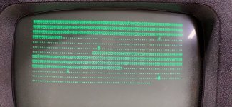

I am fixing an 8032 Universal board for a friend. When powered up, the computer chirps and reports Commodore Basic 4.0 message along with
the amount of free ram. Here is where the issue is. It says only 50 bytes free. I have had luck in the past fixing ram issues by piggy backing
ram onto existing ram, to locate the bad ram. That trick did not work this time, even with 16 good 4116 rams chips piggy backed. it got me thinking, basic is working, some ram is working, the CRTC is working. What could the issue be? So I loaded up an eprom with the DiagV4 diagnostic rom image (PETTESTE2K – Version04.), turned on the computer and got the image below.
The diagnostics stops on the page 0 and page 1 test it looks like.... it got me thinking:
Could it be the CAS0 or CAS1 signal? I'm thinking: So without proper RAS and CAS signals I think the dynamic ram on the pet bottoms out to 128 bytes of ram. So I am going to scope the ras and cas0 and cas1 lines and see what is there... I'm kinda thinking it's not a ram issue, could be a support chip, either one of the 74LS244's or perhaps the 74LS00 (UD5) I will check what's going into those chips, and what's coming out. The data bus and the address lines in general appear to be good because Rom is being accessed for basic and the video ram is being accessed properly at 8000 (nothing strange on the screen) I'm very new to fixing pets, and sometimes a little bit of knowledge is a dangerous thing. :) I'm hoping I'm on the right track. the only thing that does not support my theory is the b's in the Pet tester diagnostic result.... hmmmmmmm
That means the quick memory check on power-on found an error at around memory location 1075 (1025+ 50). Since piggy-backing did not work, the fault may be a a bit stuck at zero.
So try a poke 1075, 255 and read back the location with print peek(1075). If it reads back something else, that will tell you what bit is bad when you convert the data to hex.
If that test passes, they a poke 1075,0 and read that location again with a print peek(1075).
Thank you, I will give that a try :) and report back. :)
Ok, poke1075,255 then print peek(1075) yields 239, which is the 5th bit stuck off?
1,2,4,8,16 so bit 5 appears to be stuck off, on the 1075th memory location? So I am back to a ram
issue? but this kinda limits it to 1 ram chip, D4 stuck at zero (UA11/lowerram) :) so I can pull that one, and see.
(or perhaps try a piggy back ram on that chip alone... )... Am I on the right path? :)
or follow the bit back, before the ram, and see if it's stuck there... :)

As dave_m has previously stated, piggy-backing only works in some circumstances.
If a RAM bit is being driven LOW (by a faulty RAM device say) - then piggy-backing it with a healthy RAM device will not help (the bit will always get dragged low).
Okie doke. It's time to fire up the PACE de-soldering tool and pull out UA11. :)
I appreciate you guys stepping in to assist. I will follow up once i get a chance to pull that chip,
and install a socket, and replace it.
Thank you Gentlemen, I now have have 31743 bytes free. :)
