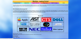

Site is managed in pure HTML. Probably not the most convenient way, but I like the 100% control, and doing everything in code doesn't bother me much. Plus, it's all pretty simple. I make the site look decent with a background image and a few jpeg tiles, I'm not very good at this sort of thing. Site has no javascript. It's all just tables and a few divs. The benefits of that are that it has the retro feel, and it (mostly) renders in old browsers.
If you want to see more of how the code works, I've had a page since launch where you can just download the whole site as a ZIP file: https://macdat.net/extras/web_dl.html
Yep, that's Windows 7.
Code shown is for a re-designed laptop portal main page I cooked up over the past day or so.
I figured the nav-bar tile based interface would get out of hand quickly as I added more brands, so I may or may not have taken inspiration from @DeltaDon's old site.
I think this looks better than the old one. Next update should have some documentation up for NEC and FIC laptops.
