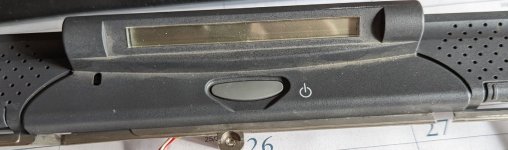

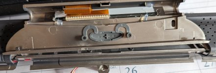

Removing the cover over the status LCD on a Green 753 (and 753+) is one thing that will normally cause the cover's two small ears to be damaged. The one "safe" way I've found to get around this issue is some creative destruction. The upper main case holds the ears in place and if you are willing to break away some plastic on this case part you can with care remove the cover without damage to the ears. Photo 3 below shows the breaking of the plastic that allows the ear to slide out without breaking off on the right side of the case. Do the same for the left side. Look at photo #2 to see a close up of the two ears.

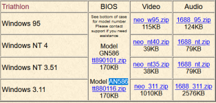

You just unintentionally solved a mystery!
I've been trying to ID this super generic laptop that the admin on BetaArchive had back in 2006, he didn't remember what it was either.
Best he had of a logo was this:
I had managed to find that AMS sold the same laptop as the Travelpro 1900, but not which company sold this one.
And won't you look at that. Also, somewhat surprising to see they were still using an image of what looks to be a Green753 in 2004 still right on their homepage...
Now to ID which one this was.
Also, I swear that Brick had the worst model names of any computer company. Who on earth hears a name like "NoteBrick" and then wants to buy one. Maybe in the mid 90s when everything was brick-sized then that would be ok, but by the 2000s when thin became the game, I can't imagine their brand did them much good. That also probably led to the somewhat humorous "ThinBrick" laptop (which was a Green755). No wonder they went defunct. They should have stuck with Ergo instead.
In any case, they're another one for the list of OEMs to process through and document.
And, found it. Ergo Triathalon. Not a bad name actually, should have dropped the "brick" thing.
