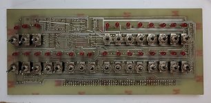

In my covid induced state last week, I purchased an Altair 680 front panel. Neither the seller nor myself could tell if it was for a 680 or 680b.. it has no MITS markings on it. Anyway, I had assumed it wouldn't matter, I thought the 680 and 680b front panels were the same.. but lo and behold, it does not physically fit in my 680 case. Did they change dimensions at some point? Is the 680b case larger?
They appear to be about 0.25" larger than that all the way around. It's weird. They appear to be correct.. everything is in the right place, the PCB substrate looks vintage.. but the ICs are dated 1979. There are no MITS markings and no silkscreen. Very weird..

For the most part, the 680b was the first operational version of the computer. The original 680 never quite worked and the 680b replaced it just a few months after the original 680 was announced. The front panel board did not change dimensions between the 680 and 680b. You must have a “home-brew” version of the front panel.

Interesting. I didn't know people were home brewing Altair boards. I don't know how I find these things. It was kind of what I was planning to do myself anyway since finding an original board is really hard.
I may just salvage the switches and LEDs for my 8800. I don't know how easy it would be to only trim off a quarter inch around the board.
Shouldn't be terribly difficult. I use a tile saw to trim raw PCB stock. An oscillating tool with the appropriate blade should be able to trim your boards. There appears to be plenty of excess stock around the perimeter.
I have tried both those things in the past and usually end up, even with guides and such, cutting away what I didn't want to. What I usually cut PCBs with is a score and snap tool, and then break the piece off. But because this is such a small amount to be removed, I'm not sure it would work. I suppose a laborious way might be to sand it down on the edges.
Very weird.. I wonder why they went larger than spec. I guess maybe they built their own chassis. I'm able to fit the switches in place into the holes in the front panel, so the PCB tracks etc seem to be scaled properly. It's just getting that extra material off safely.
If you have a reasonably steady hand I'd probably vote for a dremel with a cutting disk; clamp an improvised metal straightedge along the line you want to cut to keep from going in too far.
Before I'd use sandpaper, I'd use a shoe rasp--much faster on FR4 stock or a coarse file. Of course, a belt sander with say, 80 grit paper would probably also make short work of the job.
