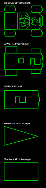

I have been working on porting ICE RACES to work on any 4050 computer with the R12 Enhanced Graphics ROM Pack (included in the vintagetek.org MAXIROM Pack for the 4051, and included in @jdreesen Multi-Function ROM Pack for the 4052 and 4054 computers). In doing this port, I found that even the ICE RACES cars have too many vectors for my 4054 to draw both cars at a high enough frame rate. The Option 30 Dynamic Graphics board contained a Signetics 8x300 microprocessor. This microprocessor was a RISC and only had 8 instructions but a 16-bit instruction word and mask, rotate, shift and merge operations could be done in a single instruction cycle! The Option 30 board contained 32KB of DRAM to store all of the refresh vector objects that were created by the 4050 BASIC program using RDRAW commands following an ROPEN x where x is the object number. An RCLOSE command would end the creation of a dynamic graphics object. The VISIBILITY x,y command would then be used in the 4050 BASIC program to enable or disable object x. Typically the position of the dynamic graphics object would be set with a MOVE X,Y command prior to the VISIBILITY command.
So my port to R12 Enhanced Graphics required I understand this object creation process and create an R12 vector string variable for each Option 30 dynamic graphics object. Since the Option 30 board cannot do object rotation, the ICE RACES original program creates 12 objects for CAR 1 and 12 objects for CAR 2, with each CAR object rotated by 30 degrees. I used A$ to L$ to create 12 CAR 1 objects and M$ to X$ to create 12 CAR 2 objects by modifying the ICE RACES program. Since this program creates all the car objects each time it runs, it takes 30 seconds to initialize all 24 car objects on my 4054A. When I created my 24 car objects as 24 R12 string variables, I decided to write these strings to my Flash Drive, and modify the main R12 ICE RACES program to read them from the Flash Drive. This reduces the image initialization to about 1 second on my 4054A with Flash Drive.
Then I completed my mods to the ICE RACES program which included modifying the instructions screen to accommodate fixed text size of the 4051 and 4052, and because I had used all 26 BASIC string variables (Y$ and Z$ hold the current rotation of Car1 and Car2 respectively), I had to change the main menu choices from strings to numbers. I also had to change the game screen countdown clock to use PRINT @32,24: statements inside a loop with a constant string variable containing the count, and changed the reporting of laps completed to a text bar graph with a stored block character for each lap completed.
When I ran my R12 modified version of ICE RACES on my 4054A, the two cars took so long to draw that the flicker between drawing car1, then car2 made the game unusable. Option 30 can draw 1000's of vectors a second on the screen, depending upon the length of each vector - since the 4054 and 4054A vector generator performance is based upon vector length (the 4051 and 4052 display board draws vectors of any length at a constant although much slower rate than the 4054). Examining the original program for the car vector length - the CAR body contained 74 MOVE or DRAW vectors and the CAR 1 outlined number was an additional 12 vectors for a total of 86 vectors for CAR 1. CAR 2 had 16 vectors for the outlined number 2 for a total of 90 vectors. The Option 30 board should be able to draw both cars at a rate of almost 6 times a second with minimum flicker.
I decided to draw a simpler car and reduced the number of vectors to 31 for the car body, 5 for number 1 and 6 for number 2 for a vector reduction of 2.4x and I got both cars drawn in R12 refresh mode in about 1 second - which is ok for game play on a 4054 but not my 4052 or a 4051.
So I created a simple rectangle with a front 'v' car with no wheels with 6 vectors for the body and total of 11 vectors for car 1 and 12 vectors for car 2 for a reduction of almost 8x from the original ICE RACES car vector image! This car image plays better on my 4052, but I don't have a 4051 to try it on. I have timed the 4051 Emulator modified by @WaveyDipole to add Flash Drive storage plus 4050E 8-Slot ROM Expander with 4051 ROM Packs including BINARY Program Loader and 4051 R12 Enhanced Graphics ROM! The Flash Drive which allows BASIC programs to access other files (only single directory of files is currently supported) on the https://github.com/Twilight-Logic/Tek405xEmulator at a car refresh rate of 1 second. This is still pretty slow, so I designed the simplest shapes: a triangle for Car1 and rectangle for Car2 with no numbers to reduce the total vector count to 4 for Car1 and 5 for Car2. Now it appears the program code that displays the two cars is limiting the frame rate. Since the 4052 and 4054 are about 10x faster than the 4051 due to their 16-bit bit-slice CPU architecture, they both get a faster frame rate since they can run the program code much faster. The 4052 has the same display board as the 4051, so the R12 graphics performance will be nearly identical if you are just drawing the graphics - such as running the R12 Picture Demo program.
I have posted a new folder on my Tektronix 4050 program repository: R12 ICE RACES with an ASCII program that allows you to select one of the four car types.

Some of my learnings about programming for the 4054 Option 30 included:
  1. Creating a vector object can only be done by running 4050 BASIC statements with standard RMOVE and RDRAW commands between an Option 30 ROPEN x (x=object index) and RCLOSE statement.
    • This means every program must create the objects in BASIC statements that result in writing to the Option 30 RAM - which could take a long time
    • For the ICE RACES game, each car requires 12 objects be created at 30 degree rotation - took 30 seconds for both cars on my 4054A without an Option 30 board - so it could have taken longer.
  2. VISIBILITY statements turn an object visible=1 or hidden=0, and multiple objects can be visible at the same time
  3. Option 30 cannot rotate objects, so you have to create separate objects rotated in the BASIC statements used to create each object.
    • Option 30 supports 64000 objects (more than the Option 30 RAM can hold) so typical objects for a CAD program might be different shaped lines, or electrical components, etc.
  4. The 4054 Option 30 user manual indicates Option 30 can draw about 1000 refresh vectors per second - more or less based on vector length since the 4054 display architecture draws vectors at a constant speed of 45K CM/sec! This is about 10x faster than the 4051/4052 drawing speed which is a constant rate independent of length of the vector.
    • For the ICE RACES game, CAR 1 has 74 vectors for the car body and 12 vectors for the outlined number 1
    • CAR 2 has the same 74 vector body and 16 vectors for the outlined number 2
    • Total vectors for the two cars is 176 and each vector in Option 30 DRAM takes 11 bytes or 1936 bytes for the two cars at various rotation angles - not even 1 percent of the available Option 30 memory and a possible refresh rate of 5.7 times a second for both cars - which would yield pretty smooth performance
  5. Converting Option 30 12-bit relative vector objects to R12 Graphics Enhancement 10-bit absolute vector strings was a bit of a challenge
    • I created the car objects based on the relative size of the Option 30 car with https://virtual-graph-paper.com/ (saved graph attached)
    • Using the bottom left corner of the larger car in the image as the 0,0 absolute coordinate, I used virtual graph to measure the distance to the endpoints of each vector and recorded the vectors in an excel spreadsheet
    • I then took the center of each object (absolute 19,22) and subtracted from the lower left corner of the object to get a relative coordinate to the center - to match how the ICE RACES DATA statements created the Option 30 car.
    • Then each subsequent endpoint was measured on virtual paper as absolute coordinates and recorded in the spreadsheet in three columns, X, Y and Move/Draw. I chose to use 1 for Move and 0 for Draw which matches the R12 vectors - but noted that Option 30 uses the opposite definition for Move/Draw.
    • I then created the relative MOVE/DRAW DATA statements from my relative coordinate columns.
    • I used the main program to create a separate program to create my Flash Drive data file with R12 vector strings
    • This program would draw each car in storage mode - which helped me fix any errors in my DATA statements, and then the program would use the INPUT@32,24:X,Y command to determine the endpoint in absolute GDUs - which are needed to define R12 vectors.
    • Computed GO TO statements would select the appropriate string variable and use the R12 CALL "DEFINE", A$,G,X,Y command to convert the 10-bit X and Y GDUs into three 7-bit ASCII characters and store the MOVE or DRAW vector into the string at an array index based on which CAR was being drawn at that time.
    • After all 24 string variables were DEFINED, the program opened the DATA file and began to write all 24 strings to the BINARY file.
    • Finally this test program would PAGE (clear) the display and rapidly display all the rotations for both cars in refresh mode. This would catch bad (off-screen) vectors.
