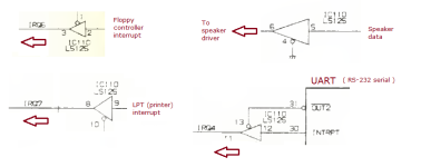

Before (fusible resistor open-circuit), there was no +5V going to IC110. Now there is, so IC110 is now operational.
The four gates within IC110 are pictured below. IRQ6 is now working, which allows the 'floppy controller reset' to happen. The speaker now works. But nothing passing through the four gates should prevent a screen display.
Have you been playing with the motherboard jumpers or DIP switches, and forgot to restore their settings to what they were before ?
The LK1 to 3 links previously discussed are now back to normal - i.e unabridged. I can only think that perhaps I knocked the switches on the side of the PCB that do control monitor related display functions.
You were right! 😊
It was the DIP switches. I set them back to default for an MD display and it all worked. I must have knocked them.
