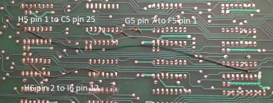

Ok, just doing a visual inspection of the board, and it has some bodges that I think are factory?
Trace cut in between E6 and E7.
Trace cut between G6 and G7
Jumper wires on the back.
H5 Pin 1 to C5 Pin 25
G5 Pin 7 to F5 Pin 1
H6 Pin 2 to I6 pin 12
The board also has the old white single wipe sockets on the VIA and PIAs.
G7 is socketed, because I had it in my head that you needed ras and cas for dram refresh.. doh..
I have seen a factory modification to some of the PETs related to cutting tracks and jumpering. Not sure whether this is the same modification though.
