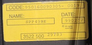

Anybody recognizes this tape unit?
Could you provide an image of the cabling setup?
The lid looks like those that Overland used but a 1999 model would considerably newer than anything I have seen.

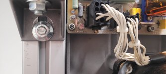

The cables have been cut-off, but this is the backside.
This is a picture of the power transformer and the air conditioner.
Originaly this unit was placed in a black metalsheet enclosure, but for demonstration purposes I made a standard with Boycon aluminum parts.
It's an early 70's Ampex low-cost drive
I'll need to dig through my scanned magazines if I have an ad
You can see the Ampex logo on the relay board and you should
be able to date it by the date codes on the IC cans.
There is no way this is a 1999 drive

I wonder if the '29783' means 297th day of 1983?
Agree that this is NOT 1990s manufacture, given the presence of those two big carbon composition resistors (they would have been sand resistors or metal film in 1990s).
