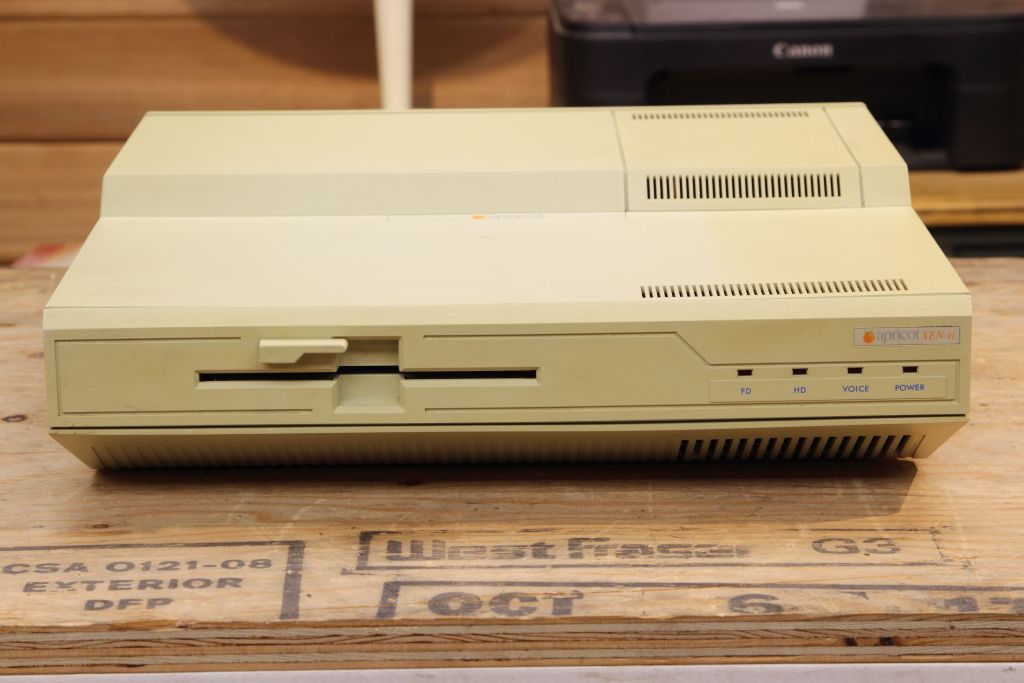

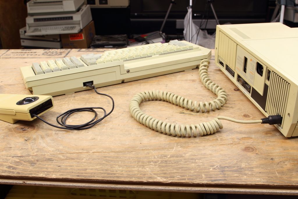

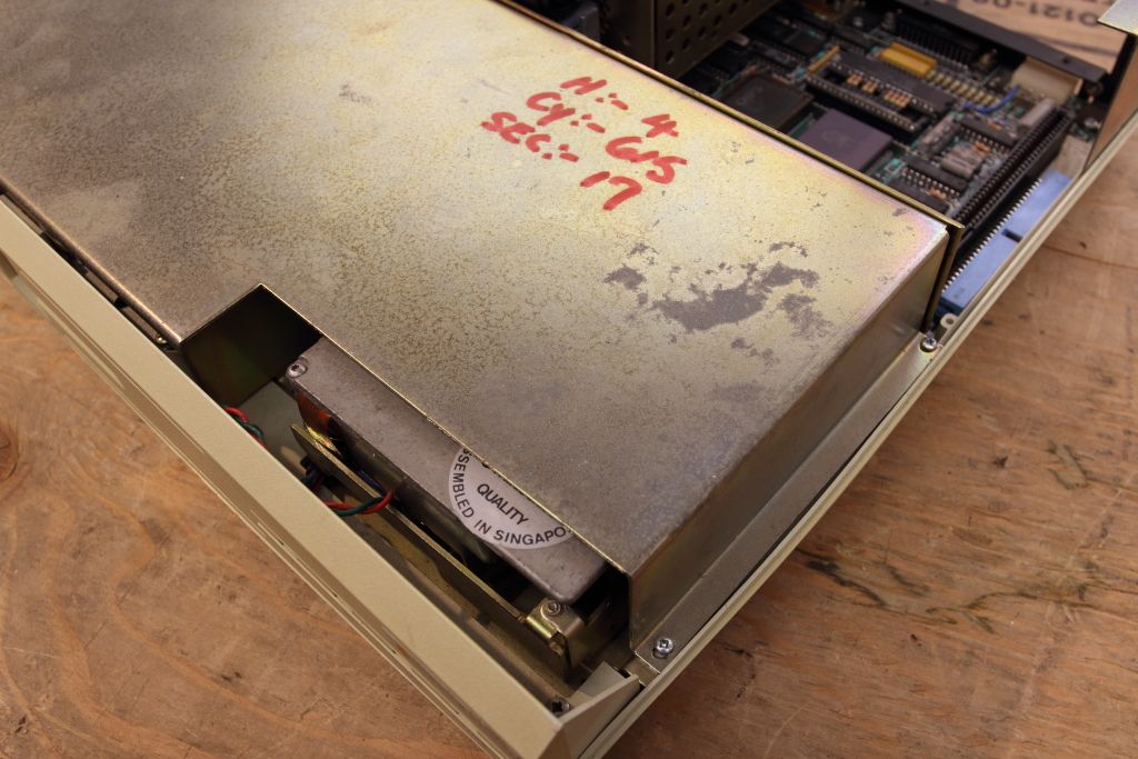

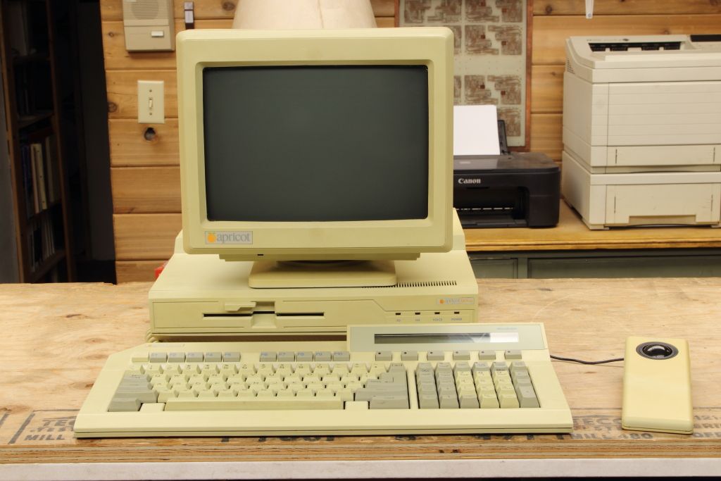

A Xen xi with an internal 5.25" floppy drive, a hard disk, the keyboard with the Microscreen LCD and the trackball mouse. The only thing that was missing was the page white display with the matching enclosure. The green monochrome screen was an option. There is also two batteries in the machine (a pair of 1.5v AA's and one 3.6v rechargeable Ni-CD) however neither had leaked seriously enough to cause any real damage. The only maintenance aside from a heavy cleaning was the power supply needed a recap. IT worked and it would POST but several of the larger 2200mfd caps on the secondary side had either begun to bulge or were leaking.

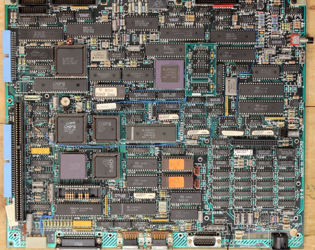

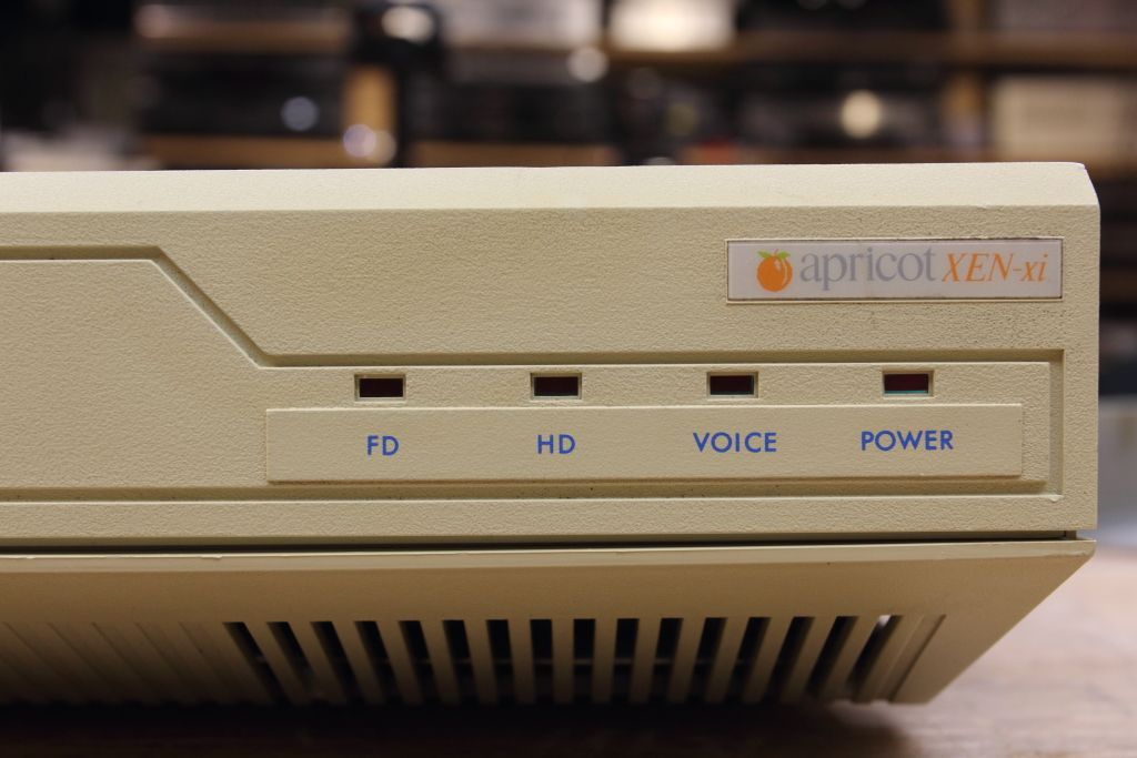

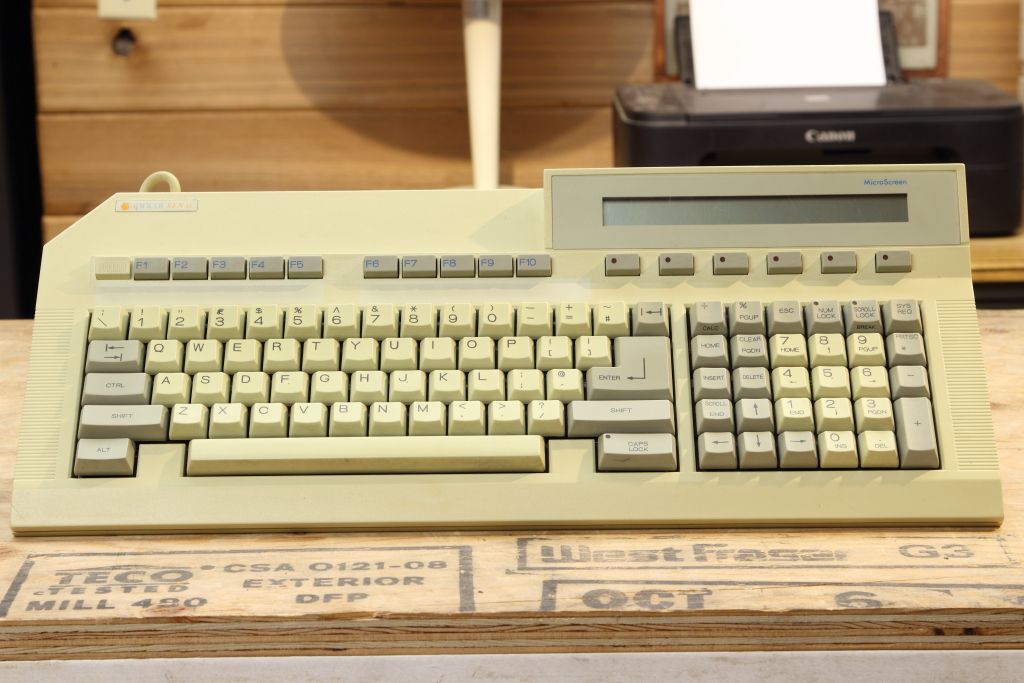

Still, there's mysteries afoot. Nobody really knows or can remember what the VOICE indicator was for. The Xentel telephone option didn't use it (that I've found yet). The computer could only dial numbers for you as part of the package. Curiously though the back of the keyboard is a 2.5mm TR jack. Inside the keyboard that routes through an LM251 op-amp and then disappears into the keyboard's PCB. Hanging around keyboard port on the machine there's a MIC jack which routes a wire three inches away to another part of the board with a MIC OUT header. You can see it on the motherboard photo above. It's well known that the Portable supported speech recognition but did they for some reason include it in the Xen? Never seen that in any of the sales literature.

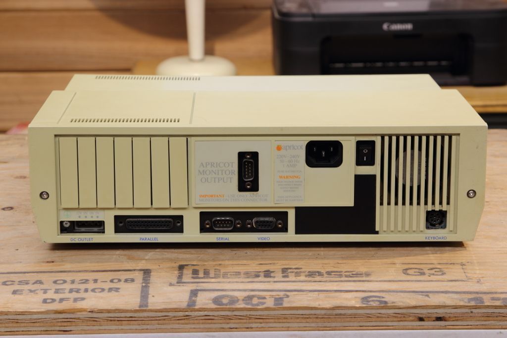

I can help a little here, as I worked at an Apricot reseller in the 80's and 90's. The Xen-xi was a 'budget' version of the Xen-i with the integrated Ethernet removed.(the blank space on the rear under the power switch is where other models had a 10BASE-T connector). The Voice light was related to the option for a voice recognition system (mainly used for dictation applications).

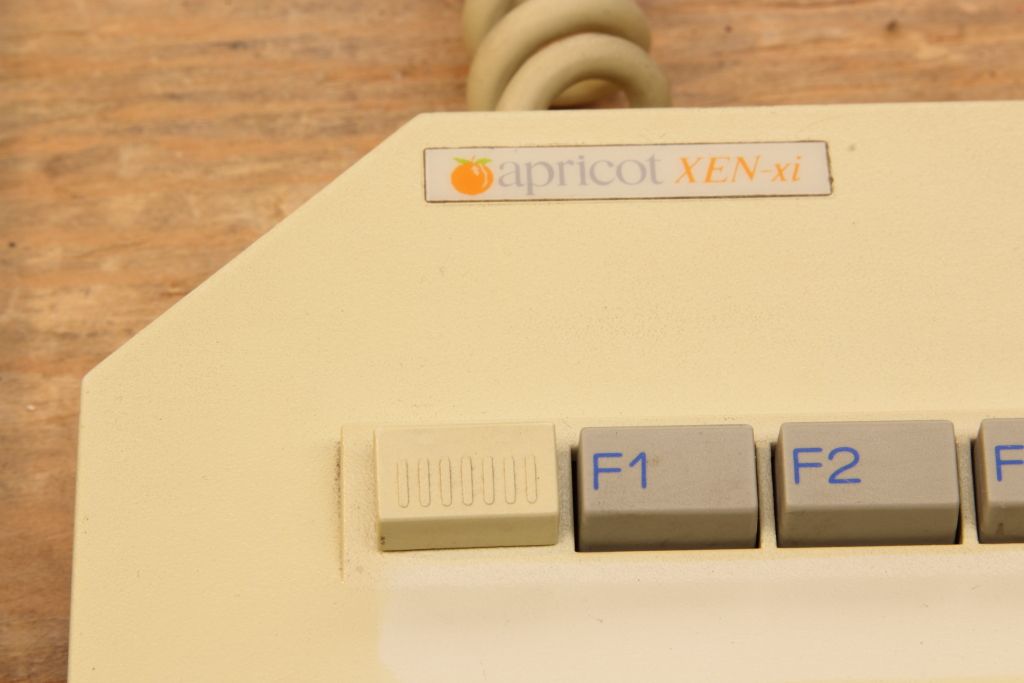

The small plastic button the left of the F1 key was removable (on earlier machines) to reveal a mounting socket for the stick microphone, but this feature never really took off and the keyboard plastics were altered so that this was no longer removable. The LED on the fascia of the computer remained simply because it was cheaper to leave the case moulding unchanged.

That really answers a bunch of questions I still had about the unpopulated and seemingly impossible to use (on later models with the internal PSU at least) mount point for ethernet and the voice recognition but never would I of expected the chunk of plastic on the keyboard was what remains of a microphone stand!

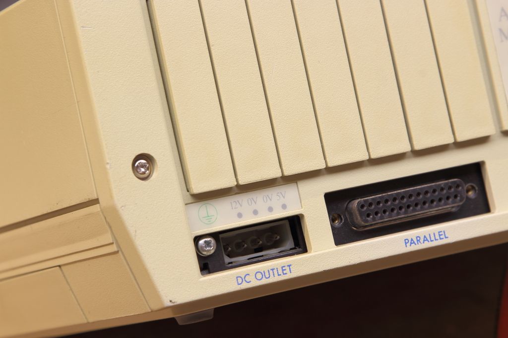

Yeah I can see how upset dealers would of been about the switch from 3.5" back to 5.25". Moreso since in a few years the PS/2 would really push 3.5" mainstream and they would have to revert back again. At least the Xen seems to provision for an external floppy drive.
