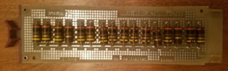

There are a variety of Q-bus "minimum load modules" (with helpful LEDs) for testing the power supply with all of the cabling into the backplane, without risking damage to expensive boards. The dual M7556 has load resistors and LEDs for +5VBB and -15V (presumably they meant -12V), and the quad M9060 can have load resistors for +5V and +12V. Note that there are a variety of stuffing options for the M9060 - the -YA variant I have is only populated for +5V. Presumably there is at least a -YB, variant with different parts stuffing. Since you won't have any other boards in the chassis, you don't need to worry about grant cards, etc. I'd stay out of the first few slots that are Q/CD and just put the load board(s) in the higher slot numbers.
Now that I'm thinking about it, I should probably just dig out the solder sucker and stuff the +12V side on my M9060 - it only needs an array of load resistors, an LED and the current-limiting resistor for the LED.
What value for the "-YB" load resistors? Some old notes from Noel Chiappa:
For debugging power supplies, a 'load module' (a card with only a bunch of resistors on it) is invaluable. No trying to figure out where/how to connect a large load resistor - just plug the board in.
DEC made several:
M7556 dual - +5V 1A -15V 375mA
M9049 single - +5V 0.25A(!)
M9060-YA quad - +5V 5.3A
M9713-AA dual - +5V 2.75A -15V .75A (KDJ11-E Load Module for 11/94)
The M7556 (at least) can be used on both QBUS and UNIBUS backplanes (since they share the same pins for +5 and -12V (QBUS) vs. -15V (UNIBUS). Probably all the others can be used on both buses, too, but check the pins they draw from first.
The M7556 can be easily modified (with a few etch cuts) into a +5/+12V load module, but the resultant board can _only_ be used in a QBUS.
If you can't find any of these (there are none left on eBay, but other suppliers still seem to have them), another alternative is to get a blank prototyping board from Douglas Electronics (http://www.douglas.com/), and add your own resistors.
