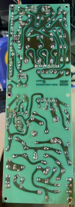

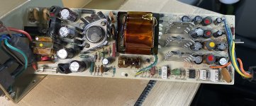

Hi everyone, I'm trying to get old Darth Vader Apple II running again and its power supply is giving me a hard time. No visible signs of life on power up. Took the power supply out, it is an Astec AA11040B. No voltages at any of the pins (+5,-5, +12 or -12) all dead on multimeter. Testing this with a multimeter between the ground and each wire in the connector.
Tried:
-Fuse tested ok.
-Went through and did a cap kit and replaced the cracked RIFA (kit sourced from console5). No change. Note the capacitors I pulled were testing ok in the ESR with a few out of spec.
-Desoldered 1 leg and lifted to test all the diodes, tested all ok.
-Transistors Q1, Q3 were removed and tested outside of circuit, seem ok.
-Went through board looking for cold joints, nothing obvious but touched up anything remotely suspect.
-IC1 (TL431CP) was replaced, original is ok - behaved same as replacement with diode tests, looks like a transistor but it's not, which is why it didn't test proper initially.
-T3 transformer was removed and continuity tested according to another post based on this thread: https://forum.vcfed.org/index.php?t...ply-aa11040b-ticking-problem-when-cold.57242/.
-Diodes D11, D5, D4 were removed and replaced with 1N4148s that I had in my stock (the old ones tested ok, so this was a shotgun replacement that wasn't needed but it was on this thread: https://tinkerdifferent.com/threads/apple-ii-astec-power-supply-aa11040b-low-voltage-repair.2876/).
I read that sometimes there needs to be load to make the voltage show, so I did try putting some load on the +5 and +12 connectors (89ohm resistor for both) but that had no effect.
I need some help to figure out what else to do diagnostically to get the supply working again rather than me stumbling around replacing components. I have access to an old slightly out of focus oscilloscope if that would help, but I need guidance on what to do with it.
Thanks!

Where I am right now with the above mentioned power supply - replaced the capacitors (I kept the originals, they measured ESR ok and can put them back if that's recommended), continuity checked the T3 transformer, and checked the transistors and diodes out of circuit. There's something else beyond my current capacity and that's why I'm reaching out to get instructions on how to continue deeper debugging with the means I have (oscilloscope available, logic probe and multimeter) and I prefer to explain what has been tried in detail.
My preference is to keep as much of the original hardware as possible.
I did measure 115VAC at the entry point to the high voltage section, so the connector/fuse seem to be ok. I need to know where else to put the probes next.

Ok, with the schematics you can start some work. The actual schematic for the B unit is a sloppy drawing with the boxes not conveying the operating theory.
Since the basic design of the AA11190 circuit is the same on the primary (line side) and the negative feedback pathway, its better to use that for now and apply any ideas to the other AA11040B schematic. So the parts I'm referring to are for this attached circuit.It would pay to print it out.
I have attached it with just a few initial things to discuss on the operating theory and a couple of tests to do.
Firstly, notice the way they organised the 115/230V option. In the 230V case the arrangement is a full wave bridge rectifier , and in the 115V case it is a half wave voltage doubler, just with the closure of one switch (clever isn't that?)
I assume you are running off 115V, but it doesn't matter because in both cases (provided the switch matches the line voltage) there will be about 300 to 320V DC across points DC+ and DC- you can check that with your meter with the unit powered.
(the rail labelled as DC- is the "common negative rail" for the primary circuit)
The primary circuit is fairly basic. It is a transistor oscillator based on power transistor Q2. When power is initially applied, this generates base current for Q2 via the start resistor R1 (Check this and resistor R2 are not open on an un-powered test.
The collector current of Q2 then energizes the primary windng P1. This induces a voltage in the secondary winding P3. If you look at the polarities of these windings you will see that the voltage developed across winding P3, with respect to common (the side without the dot) has a positive going polarity (the opposite polarity that transistor Q2 is applying to the primary windingP1). Then current flows via R4, C-10 & T3 winding back to the base circuit of Q2, reinforcing the conduction of Q2, this causes Q2 to go into a saturated switching condition, when its collector to emitter voltage drops very low.
We now have the 320V DC switched across the primary P1 of the main transformer P1. This state cannot persist for a few reasons.
The voltage induced across a transformer winding is proportional to the rate of change of current with time. And the rate will fall off as the core begins saturation the induced voltage across P3 will fall away. Anther reason would be that as Q2's emitter current develops a voltage across R12, then via R10 & R7 it drives the base of Q1, this shunts Q2's base drive causing Q2 to start to cut off.
Therefore, even without any negative feedback via T3 from the secondary system of T2, Q2, after a while would cut off. When Q2 does cut off it does it rapidly because the field in the main transformer starts to collapse and the voltage across its terminals reverse as does the induced voltage across P3.
Then the process repeats and you have Q2 applying a square like wave drive applied to the primary winding P1.
The idea of the additional winding P2 is to damp the field collapse via D3 and control the rate the field collapses when Q2 is turned off and prevent a large positive going voltage spike on the collector of Q2 destroying it.
It is the duty cycle of the oscillator that is Q2 , determines what the output voltages will be on the secondary of T2.
It is Q1's job to control or reduce that duty cycle, either by detecting over-current via the current sense resistor R12, or by receiving a negative feedback signal from the secondary side of the supply via T3 (T3 provides isolation from the secondary side of the supply to the primary, some PSU's use opto-couplers instead)
The first questions, therefore, confronted by a PSU with no output :
Is the DC voltage present on the primary circuit ?
Is the primary circuit complete (the resistor in series with P1 not open) Output transistor ok, current sense resistor and other emitter resistor and diode not open ?
Is the transistor receiving its start up base current is R2 and R3 ok ?
Is the feedback pathway P3, R4 and C10 and secondary winding of T3 ok ? And Q2's base inductor and resistor OK ?
If Q1 was shorted, or D4 shorted this would kill Q2's base drive so check that too.
Therefore if all of the above is in fact ok, then the primary circuit should be oscillating. That is the next thing to determine. This can be done by powering the supply via a Line isolating transformer and using a x10 scope probe (but a x100 is better to protect the scope and probe as sometimes the peak voltage here can be over 400V) with the scopes earth clip on DC- (common) and the probe tip on the collector of Q2. Don't attempt it without the isolating transformer, it must be isolating type, not an auto-transformer.
A lot of the time though, you can avoid using the scope on the primary (live) side to check for oscillation and simply use it on the secondary side of the main transformer, were the voltages are scaled down and isolated too. A meter on the primary side is ok as it is a two terminal instrument and completely isolated.
For example, it could possibly still be oscillating, with a duty cycle that is so narrow that there is negligible voltage on the secondary.
If the SCR crowbar circuit is triggering on/immediately after power up (which can happen if a suitable dummy load isn't applied to the supply's +12V output and COM terminals) or the SCR or its gate circuit defective. The shunting effect is so significant on the transformer secondaries, it completely kills the induced voltage across winding P3. The oscillations are terminated, and Q2's collector current remains a low value, due to the low base current of the start up resistor.
This effect was one of the things that made self-oscillating DC:DC converters attractive. If the output gets shorted out, the oscillations driving the primary are extinguished so they are self short circuit protected.
A question: If you have checked the transistors Q1 and Q2 and Q3 and Q4 and the SCR for that matter ...how did you check them?
And what have you been using for the Dummy load?
