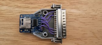

Tried multiple different thumb drives from diff mfgrs.. no change. Guess I'll switch to my oddball LPT<->SD adapter, since that works, albeit slow too (not that the CH375 is fast), it consistently worked for me on the Tandy.
So I missed something I think. Did you write SDLPT v1.1? It's distributed as one of two drivers by this person - its an odd arrangement, you physically change a jumper over depending on if using the NC100SD or SDLPT driver.
See my prior post where I linked to the SD/LPT thread/device I'm referring to. I didn't write any driver.. I built one of the things (see picture) referenced in that link.
