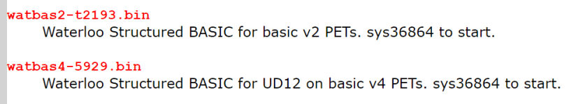

Here I found the missing rom
A friend in the UK downloaded it and burned it to a memory stick rom, installed it in his computer and he says it still doesn't work - we have identical machines - what could be the cause? what are we doing wrong?

Are these to be burned to a chip? Is this the cracked version (1.1), or is it the original version 1?
From my understanding, Waterloo BASIC is on a chip (in UD12) which is normally an empty memory slot (PET 4016/4032/ CBM 8032), at memory address $9000.

What I meant to ask you, is the file you linked is for the PET 4016/4032 and CBM 8032 (6502 board)?
It doesn't say. However, I suspect it doesn't actually matter either. The revision of Commodore BASIC is for all 6502 PETs. The EDIT ROM is the difference only.
The difference between the two Wayerloo image versions is the revision of the 6502 BASIC that is installed in the existing PET ROMs.
It specifically states UD12.

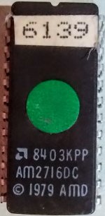

This is what I have in UD12 of my 4x CBM 8032s. From different purchases, but 3 were in schools. I would guess the white sticker could be a serial number issued by Watcom.
Sadly, there is nothing in UD12 of my PET 4032s.

UD11 is another option ROM, it is at a different address to UD12.
Yes, you can just move an existing pre-programmed EPROM from one machine to another - with the proviso that it is running the same version of Commodore BASIC (as indicated by the message on startup).
Yes. This is what enabled PET 4016/4032 and CBM 8032 to run Waterloo BASIC. I have a few more chips to check out. Hopefully I will have 3 or 4 of these that work.
Turns out I only have 2 that work. Pins are damaged on my 3rd chip.
It's very old stuff so I doubt anyone can burn the v4 bin file anymore. Maybe some are on eBay. I will need 3 more.
As I said before, these devices are 2716 EPROMs (still available) and all you need is an EPROM programmer - or someone who can burn them near you for cost and a beer.
