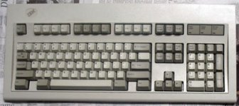

I can confirm to you that my true blue IBM Model M "AT style" keyboard (100-something keys, Spanish International layout) with a DIN plug works with my true blue IBM XT, and also works with my AT clone Pentium-1 machine (which has a AT keyboard connector, not a PS/2 one). This Model M keyboard has no leds for caps lock, num lock, scroll lock. I guess it must be doing some autoswitching because I don't manually switch anything in it when moving it from the XT to the Pentium, or when moving it back from the Pentium to the XT.
When I got the IBM XT, it came with this Model M "AT style" keyboard.
It has always bothered me its lack of the lock led lights, so I have since got a 80-something keys real XT keyboard (Spanish layout) with the function keys on the left side, and with nice led lights integrated in-key in the lock keys.

There are many models of the Model M. The Model M you have might be a 1390120 (or a derivative), which was explicitly designed for an XT. It has no lights because an XT wouldn't use them anyway.

Actually, mine is model #1391401; probably the most abundant of the gray labels. Not that that really means anything. But mine does have the lock LED's. If I had my wish, I'd get me the spacesaver model without the 10 key area. Those go for a premium though. IBM made so many models that I don't think they even know what they made and what they didn't. But if a space saver came up that was in decent condition for less than $50 or so, I would almost have to do a monkey jump. Most seem to go sell on an average over $150.00. I can't afford to buy a space saver for even $50.00 right now any way, too many hands in the pot as it is. Not with the expansion unit and the Compaq Portable I'm in the process of buying.

Now that is something... I have never seen an AT style model M. Do you have pics? I would love to see it.
Well, I call "AT style keyboard" to the standard 100-something keys keyboard with the F1 up to F12 keys at the top, as opposed to the "XT style keyboard" which carries only 80-something keys and has the the F1 up to F10 function keys at the left.
The IBM Model M keyboard which I have is like the one in this picture, but without the lock led-lights at the top right side.
