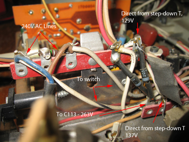

Ok, here is an update.
First, the first few components up to C113 seem different than the SAMS schematic (This is in the SAMs document in an earlier link but I have just the schematic itself linked here).
Measuring across the two AC lines after they leave the isolating transformer shows 115V. I traced the two lines through until they connected to other components. Measuring voltage from the two lines when they link up to the first piece of circuitry to ground, gives the voltages shown on the following picture. One line gives 129V, the other 137V. I've shown where they connect.
The yellow wire shown (arrow points to lug it's connected to) goes to C113, - Voltage is 263V? SAMs (and Chuck) says this should be 133V. It seems to be double?? The other lug on C113 measures 172V. I've checked these voltages several times.

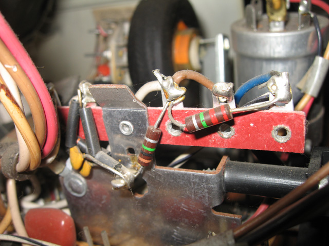

There is another thing I noticed tonight. One of the legs of a small component attached to the bottom of the tube has snapped. I'm not sure how important this component is...or even what it is...it looks like a clear LED. Anyway, here's a pic.
Figure 2
Any advice on what this is and how to replace it most welcome.

The ground or reference point I'm using to measure the AC voltages (apart from across the two wires prior and after the step-down transformer) is a lug off C113...which is directly wired to the chassis.
So that particular lug must simply be one that is intended to ground the metal case of C113. The two other lugs are for the actual capacitor.
263V on one lug minus the 172V on the other lug would mean that C113 has 91V over it (263-172). You could verify that placing one probe on one lug and the other probe on the other lug.
So, why isn't one lug at 0V (chassis potential) and the other at 91V ? Parts of the power supply circuitry that one may expect to be sitting at chassis potential may be sitting at a potential above that of the chassis. It comes down to the design. Remember, so far, the power supply has differed to the document you have.
It is a spark gap (for protection). Ignore it for now.

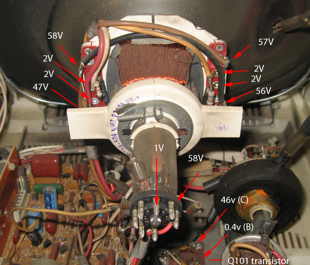

Ok, some more readings as shown on the image. The horizontal output transistor values are at the bottom of the screen. As you can see, only 46 volts on the collector instead of the 92.2 the circuit diagram tells me to expect. Some low values on the tube too, yes?
It's interesting that that's half the voltage on the collector of the transistor, yet the big can (CR101) carries twice the voltage the schematic says it should on the input lug.
I also measured the voltage on the neck pins. Only two had any voltage as shown.
Figure 4

Could a faulty Horizontal output transistor be the problem here?

Let me think about this, but here's something to do in the meantime. See all of those big power resistors (block-ish rectangular tan-colored things) scattered around the chassis? Measure each one with your ohmmeter (power off, of course). In no case should the resistance ever be substantially larger than what's marked on them.

Yes, the horizontal output transistor and/or the flyback transformer are among the most common failure points, but let's do some more checking first
The 'spark gap' is actually an NE-2H neon bulb (DS101 in the schematic); similar to a spark gap but instead of shorting above a certain voltage it 'clamps' the voltage at around 70-80V. It should probably be replaced, but I don't think it has anything to do with the current problem.
Just simple voltage measurements can be misleading in circuits like these; I think you have a 'scope now (or was that Phil's?) so why not see whether those voltages on the deflection yoke (for instance) are DC or whether there's actually a signal there?
Yes, I do have a scope now. I did drag it out and consider using it but, but given I'm a newbie at TV circuits I didn't want to accidently blow it up. If I did zap something I'd rather is be my $30 digital multimeter. However, I'll start using it.
