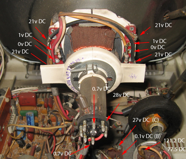

First the big Pot C113. 121.2V on the yellow lead (from the two diodes in figure 1 in a previous post) and 77.5 on the RED.
The transistor. 27v. Way lower than the 92.2v it should be. 0.1 on the base.
Around the tube. 21V, 1v and 0v as marked
The tube neck. One pin is 28v, another 2 are 0.7v and the rest are 0v

Thanks Tez, that's starting to make some sort of sense! The resistors are fine--on those old "sand block" resistors +/- 20% is manufacturer's spec.

At least the resistors are in range, the voltages seem reasonable and something's drawing current.
We're getting there. You said you had a 'scope. Let's run some stuff down.
Apply your video signal to the monitor. Set up your scope for AC coupling, about 2V/div (vertical) and free-running horizontal (usually labeled "auto" or some such) and about 10 µsec per division horizontal. Apply a probe to the base of Q11 (near R472). Do you see a pulse train?
