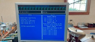

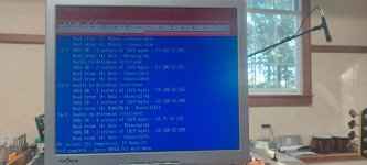

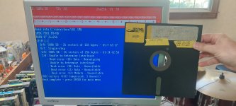

Morning update -
I've about decided that I had the drive jumpers right but that IMD is reading Track 0/head 0, reading that fine,
Then going to Head 1 and finding only EF's, and saying done. That would explain what I'm seeing.
So today I'm going to investigate the Full Analyze option of IMD to see if that reads all sectors regardless of what it thinks about data.
I just want IMD to read the sectors and save them, not try to decide if there is data or not.
And I'll revisit the 7301 disks and restart this quest over.
Thank you for your endurance on this.

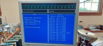

Mid-morning update -
My hardware is good, jumpers on SA850 are right.
But what is happening is that IMD is reading track 0/head 0 and finding data (CPM boot) at SD,
Then moving to head 1 of that track, finding E5's and concluding the rest of the disk is empty, and finishes.
Of course this isn't right for these iBex disks which have Directory at track 37.
So I chose the FULL ANALYZE option and it shows data on the first 38 tracks of head 0,
then some data on head 1, rest empty.
This makes sense since these ibex disks have their directory at 37, then start saving data on track 2, side 1.
This is also evidence for the ORDER parameter needing to be CYLINDER on 22DISK.
I will re-read these disks so we can try again.

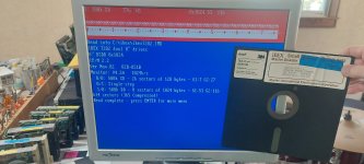

Ok, I re-read the IBEX 7202 and 7301 disks.
Hopefully this got both sides.

The 7202 disk had no errors. (this is for a dual FD machine)
The 7301 disk had errors on Trk 7. (this is a FD/HD machine)

I don't understand the imd files for these disks.
All the data for side 2 is "N".
I see side-select pin 14 on 50pin drive connector going high/low as it tries to read.
I don't have a non-ibex DSDD disk to read for testing.
These disks are suppose to be DSDD with 8 sectors per track at 1024 bytes on both sides, except track 0. that's what I thought anyway.
But according to imd there's no data on side 2.
My initial files showed data same on both sides because I had the side-select jumper wrong, so it was always on side 1.
So here's anadisk with the IBEX 7202 boot disk:
It shows all side 1 blank,
CPM dir at 37 (which we knew),
Says 8x1024 which is right, except 1st track.
Says it's a non-system disk, but it is.
