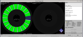

Thank you. I've been sitting on this issue since I got back from work and I seem to be going around in circles like a hamster. Somewhere I'm making a logical error and my head is confused. I'm uploading the DMK file with regular dos because I'm sure it works. It's a conversion from an HFE file. TRSTools reads the DMK contents correctly after conversion.
I'm not going to suggest anything right now, as my thinking is probably wrong. I'll wait for you to describe your example to me, and then I'll write what I did.
all the best
Arek
  • dziala_hfe_ld3-531_dsk_hfe.zip
Arek,
I've looked at your image and it isn't quite what I expected. There seems to be a lot of jitter in the
image versus what I see for l3d5136.dmk. I'm using the Linux Version of HxC which is at Revision
2601, and I'm currently using Revision 2595. A few weeks ago when I checked I was using the
latest Version.

I've attached a photo of your image with the jitter problem, an also an image that was on my TRS80GP
Emulator, for comparison.
I did get you image to boot, but if I do a DIR command after the second page scrolls, the Emulator locks up.
If you do a DIR and list two pages does your computer also lock up?
