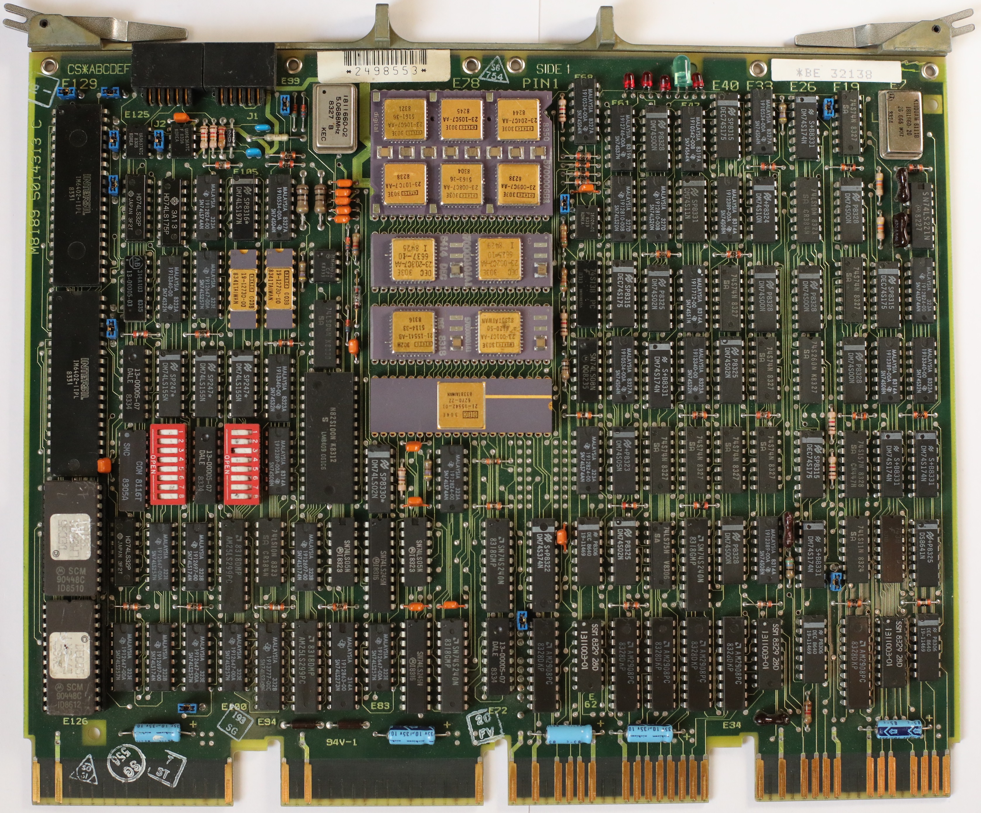

The CIS chip for the KDF11 is a monster (I have two of them) and is basically six chips to implement the CIS in microcode. It does work fine with the FPP chip (which requires the MMU for the FP registers) or with the FPF11 board (I have run an 11/23+ with both and RT11 reports EIS, FPP, and CIS options installed). Hm. Never tried the CIS chip without the MMU chip.....

This weekend I’ll try to run DIS tests on KDF-11 with CIS
Great info - can you post with disgs work/fail please! This looks like a useful (and easier than CIS) bunch of instructions to add to my emulator... would be interesting to see if RT-11 reports DIS...
Could not resist :)
VKAIB0
The first and second edits - bypassing the verification of codes that are incorrect for DIS (but correct for СIS)
The third edit is to bypass the check for interruptibility of DIS instructions (I haven’t figured out what’s wrong yet).

The second test is a little later.
The second test performs worse. Traditionally, disable the interruptibility check.
