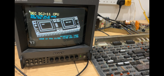

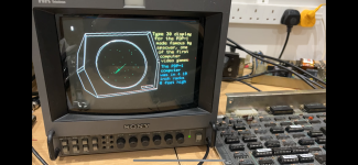

Hi, I have fixed a couple of Gigi terminals in the last year for an exhibition at the National Museum of Computing in the UK - and been working on some demos for them...
One option is to generate .SVG files online with line data and parse the files to create Regis data, this is easy to send to the terminal from a simple program on a PDP-11 - and you can edit in text and other information easily by editing the regis data on the PDP-11... Here's a couple of screens I have done this week: (yes, I have fixed the typo...)
