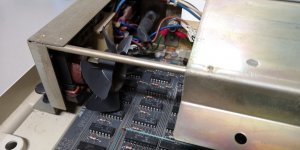

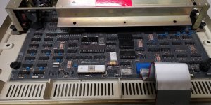

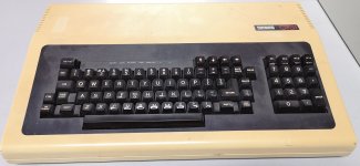

So I got the GiGi last Friday and to my surprise I got an VT241 with it as well. The VT241 was unknown and hasn't been on in this century at all. So checked the inside of the VT241 and also soldered some bad contacts in these single layer PCBs at warm components. These solder joints often give many problems in this age.
IMG_20210326_140633.jpg IMG_20210326_140754.jpg IMG_20210326_140918.jpg IMG_20210326_140921.jpg IMG_20210326_140942.jpg IMG_20210326_141020.jpg IMG_20210326_141341.jpg IMG_20210328_121125.jpg

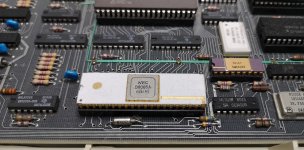

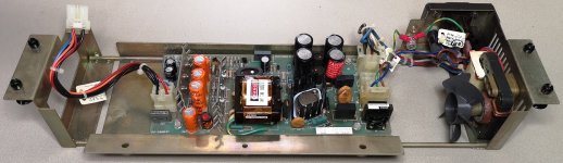

The GiGi owner told me that is was a smoke gun in the past. Well these Rifa filter caps are known to fail over the years. So I replaced these with modern ones.
Then the GiGi came to life again. It worked about two times and then the power on self test failed... I got a weird cursor with the height of the full screen. I pulled all the ROM chips with silver contacts out of the sockets. The pins turned from shiny silver into some black oxide. So I cleaned the pins and put them back in. The GiGi is online again.

Nice to see I'm not the only one who owns one of these. I got mine from a large haul of stuff from upstate New York 2 years ago, along with some PDP-11/VAX/Alpha and Sun 4m/4u stuff.
