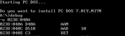

During some testing of GLaTICK we discovered a curious "bug" in PC DOS 2000 / IBM DOS 7 having to do with DOS DATE/TIME support of `INT 1Ah` real-time clock functions. On an XT machine with a V20 CPU running these versions, when using DOS's DATE or TIME commands to set the clock (or any DOS `INT 21h` clock function) the RTC would be set with incorrect values. Specifically, if you set the time as 2023-04-18 12:05:00, the RTC would read back as 1417-04-12 0C-05:00.
After some debugging and tracing, it turns out that IBM DOS 7 and its decedents replaced the code that converts a byte value to a BCD value (which `INT 1Ah` expects) with the following:
Since `AAD imm` is not supported on V20 it will execute `AAD 10h` as `AAD 0Ah`, meaning that the `AAM` and `AAD 10h` negate each other and DOS ends up passing the binary value to `INT 1Ah` instead of the BCD value, resulting in the invalid times. This code saves 8 bytes (though is actually more clock cycles) compared to the normal (and well tested) shift-n-OR method.
Anyway, just thought I'd share so it can be documented for posterity.

Right, this wouldn't affect clock setting/reading programs that run within DOS. This is an issue specific to DOS 7's CLOCK driver in the way it sets and reads a real-time clock IF `INT 1Ah` support is detected at boot where RTC is provided by the BIOS -- as it would be for 286's and up. Since very few XT's had BIOS-level support for their RTCs (and of those, fewer had V20's) this would have been a corner case for sure.

The issue is that the V20 is not 100% compatible with the 8088. Which is why it's a V20 bug.
