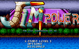

Jim Power on MS DOS also makes really great usage of it. I guess this is the result of natively composing it for the soundblaster and not for some midi platform and then cheaply port the music to it.
