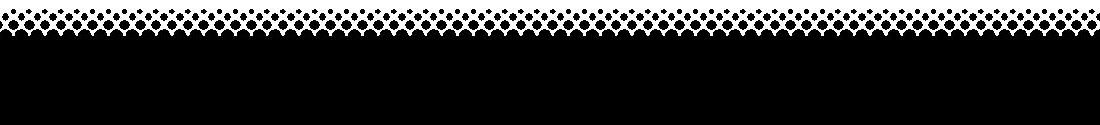

I uploaded the pattern. As you can see it does have it's challenges.
I agree on the adhesive perhaps making a mess of things but it does have a carrier under it so it's not like there is a sticky surface.

One note on the usual paper tape punch--it is expecting the tape to be 2 thousandths of an inch thick. Your tape with adhesive backing and protective strip may be too thick to use here, as it may not fit through the punch head, it may be too thick for the punches to cut through reliably--and if they do punch through they will dull down quite a bit faster than normal due to the dust having the gummy adhesive mixed in. I maintained tape punches for over 20 years. All of them have the feed hole, as it is part of the standard and is critical for timing when the mechanical readers feed the tape over the sensing pins to determine the pattern of marks and spaces.
Your best bet may be to design your own mechanical punch that you hand crank and use a set of cams to control the punch pattern. That way, you can use the three different sizes for your punch pins, eliminate the feed hole (maybe by shifting it to a tear-off area on one side of the tape if it really has to be there for stability). Cam pushes lever horizontally to left, spring pulls it right. Left position places it under punch pin and a bail can be driven upward to force the pins to pierce the paper, with gravity/springs to pull them back down. Mechanically simple and no computer required. Lobes on the cam determine the periodicity of your punch pattern for each pin. Note the feed hole can also be controlled by the same mechanism to keep everything in sync as the tape is pulled forward.
