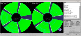

  • OSV-SYS.zip
    OSV-SYS.zip
Ah, you need to use the HxC Software to create the *.hfe file and put that on the USB Stick.
See Attached.
REMOVE the RAW image and add the *.hfe image.

Post what you have for the vixen.cfg, and what firmware you are running? Flashfloppy or HxC?
Here is what I conjured up for the Vixen.
#Flashfloppy/GOTEK
[osb8]
cyls = 80
heads = 2
secs = 5
interleave = 2
bps = 1024
id = 1
#rpm = 360
rpm = 300
rate = 250
mode = mfm
iam = no
Larry
