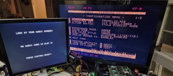

Hello all, I am running a stock Franklin Ace 1200 with the included dual interface (PR1 & PR2 virtual), 80-column (PR3), Z80 CPU (PR4) and floppy drive card (PR6) and all appear to be functioning normally.
I've verified the following functionality:
- 40 column mode without any installed cards
- 80 column mode in and out of CP/M
- Reading from sdisk2, formatting/reading/writing physical disks
- Was able to boot the ProDOS loader image from ADTPro through the dual-interface card (ADTPro itself would only give a black screen)
- a2dvi is accessible from the configuration tool, I can change fonts, colors, modes et cetra.
I have primarily used the a2dvi card though out my testing and it's worked wonderfully in 40 column mode. The issue I'm running into is I don't know how to get it to switch to 80-column mode. I can view 80-column mode through the analog video and continue to use the Franklin in analog mode but once PR#3 is ran the a2dvi stops responding; I assume this is because the computer is now writing to a different part of memory for display output. Is there a work around or modification to be made? Or, did I miss a configuration change? I do have VIDEX mode enabled, II+ US and VIDEX low character set selected.
V/R,
Kiser
Edit to add: I've used the a2dvi in PR2, it is currently in PR7 as to not conflict with the virtual serial port.
These a2vga/hdmi cards are based on one common pico design (I tried once one, but was not impressed), and the only workaraound would be to use a //e compatible computer with built-in 80 cols modes in its chipset that pico cards know about and can intercept and emulate.
I started digging into the A2DVI source code and compiling my own fork for the pi pico; I've successfully added a MACHINE_FRANKLIN to the enum list and setup the auto-detect to correctly identify either an Franklin Ace 1000 or 1200.
My initial issue is that the Ace 80 column display card does not use annunciator outputs that the Videx Videoterm would have; the a2dvi expects to see 0xC059 set in order to flag SOFTSW_VIDEX_80COL. I can force the SOFTSW_VIDEX_80COL flag as always true, however, no text displays. The cursor will move, which is encouraging.
I've grabbed a copy of the ROM from the monitor and used a dissaseembler to try to figure out what I can use to set the SOFTSW_VIDEX_80COL flag:
-Kiser

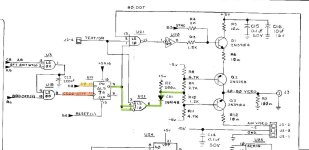

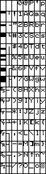

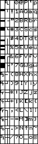

To reduce any errors from transcribing, I've dumped the ROMs U23 (program) and U24 (font) from my Ace 80-column [Video] card (Rev G, S/N E-17787). The U24 font ROM has a stamped label "U24 1331411", the U23 program ROM has printed label "1331424 .A" The font ROM does not seem to be utilized very much as seen in the first code block, the program ROM is much more interesting.
With the Ace 80 installed in peripheral slot 3, the 0xC300 - 0xC3FF memory window is located at 0x0600 in the U23 ROM file. The 0xC800 - 0xCFFE memory window starts at 0x0000 in the U23 ROM file.
-Kiser
Edit: Per the drawing, this is the "Video Card"
           00 01 02 03 04 05 06 07 08 09 0A 0B 0C 0D 0E 0F
00000000   00 00 00 00 00 00 00 00 00 00 00 00 00 00 00 00  ................
00000010   FF FF FF 00 00 00 00 00 00 00 00 00 00 00 00 00  ................
00000020   00 00 00 FF FF FF 00 00 00 00 00 00 00 00 00 00  ................
00000030   FF FF FF FF FF FF 00 00 00 00 00 00 00 00 00 00  ................
00000040   00 00 00 00 00 00 FF FF FF 00 00 00 00 00 00 00  ................
00000050   FF FF FF 00 00 00 FF FF FF 00 00 00 00 00 00 00  ................
00000060   00 00 00 FF FF FF FF FF FF 00 00 00 00 00 00 00  ................
00000070   FF FF FF FF FF FF FF FF FF 00 00 00 00 00 00 00  ................
00000080   E0 90 E0 9E F0 0C 02 1C 00 00 00 00 00 00 00 00  ààð...........
00000090   90 90 F0 90 BE 08 08 08 00 00 00 00 00 00 00 00  ð¾...........
000000A0   80 80 80 9E F0 18 10 10 00 00 00 00 00 00 00 00  ð...........
000000B0   88 88 50 20 3E 08 08 08 00 00 00 00 00 00 00 00  P >...........
000000C0   F0 80 C0 9E 90 18 10 10 00 00 00 00 00 00 00 00  ðÀ...........
000000D0   70 80 80 7C 12 1C 14 12 00 00 00 00 00 00 00 00  p|............
000000E0   70 80 60 10 EC 12 12 0C 00 00 00 00 00 00 00 00  p`.ì...........
000000F0   70 80 60 1E E4 04 04 0E 00 00 00 00 00 00 00 00  p`.ä...........
It appears the VIDEX support was introduced in the meantime so your job is probably really trivial:
Yep, I didn't realize when I bought the A2DVI that I would need an 80-column card, but I had the one from Franklin! With the extent to which it was a clone I thought I would get lucky and just be plug-n-play; sadly, that did not happen. But it hasn't deterred me yet! I hope to be able to reuse the Videx code and only adjust the memory addresses that are monitored; unfortunately I'm not familiar with Apple ][s so it's a lot of trying to understand Apple ][s and Franklin's changes. If I can get it working, I think the Franklin Ace fonts would be a nice add-on too (I've dumped both the character ROMs already).
-Kiser
This is brilliant, I hadn't dug into the schematic yet but I did give it a try with a simple test and verified writing an odd address will cause the output to swap to 40-column mode. I attempted to write to CE00 from the monitor and notice a blip in the screen and realized it had to be a continuous write otherwise the routines called from $36,$37 will swap back to 80-column mode. The following code snipped will force 40-column mode:
10 POKE CE00, 1
20 GOTO 10
Therefore, an easy way to detect which mode to display! I'm still looking for a way to hook in similar to a2dvi.
It looks to me your logic is wrong. A single access should be enough, there is even a D-trigger to memorzie it. I suppose another program code is resetting the card's state, could be its own ROM. Try to make a single access not from Basic, but from monitor. If that's not working make a short machine language program tham makes single access and then loops forever.
I initially tried just writing to 0xCE00 from monitor mode, but as you've suggested, the ZP input and output routines ($36-$37, $38-$39) point to 0xC3xx when in the Franklin's 80-column mode; those routines are preventing me from setting the D flip-flop as I'd want to. The basic script above is enough to cause the 40-column mode to be visible. Note: the video display data is preserved when swapping between 40 and 80 column modes on the Franklin hardware.
$36-$37 - Address of Output Routine (Default = F0, FD, 80-col = 07, C3)
$38-$39 - Address of Input Routine (Default = 1B, FD, 80-col = 10, C3)
To validate my assumptions, I first went into 80-column mode with the "PR#3" command, went in to monitor mode and dumped 0x700-0x707F to get something on screen, "Ctrl Z, 1" to exit 80-column mode. Back in 40-column mode, I wrote to 0xCFFF to disable all PROMs, wrote to 0xC300 to activate the IO select for PR#3, wrote to 0xC0B0 to activate Device Select. This should be all the required conditions to force the 80-column card to switch inputs... and with a write to 0xCE01, I was looking at the 80-column output of 0x7000-0x707F!
This works, because, "Ctrl Z, 1" reset the input/output routines to the defaults and negates the ROM routines in the 80-column card from over-writing the D flip flop, and the display RAM is on the 80-column card so the display data persists even when swapping modes.
See attached for proof, the left monitor is on the VGA version of an A2DVI (only displays 40-column mode), the right TV is displaying the analog output from the 80-column card (or 40-column mode of the onboard video depending on settings)
Edit to add: I have both the HDMI and VGA versions of the A2DVI, I'm focusing on the HDMI for now and I imagine porting to the VGA version will be easy. My motivation is that I do not have a CRT TV to enjoy the Ace 1200 on so I have to make do with more modern displays.
-Kiser

For those interested, here are the rendered font ROMs:
  • The ace80font is from the Franklin Ace 80 column card
  • Videx normal is clearly an inspiration for Ace 80 column, only missing the "DL" from 0x10.
  • the chr_rom is from the Franklin's color font card
  • II_US is the apple ][s font for reference
  • The graphics are ordered as 0x00 in the top left, 0x0-0xF are the first column, 0x10-0x1F would be the second column and so on...
  • The flashing characters appear to have a bit set in the first column of bits
The chr_rom was twice the size of the Apple ][ and I wasn't sure why, and wanted to see what the differences were, and I'm honestly not sure what I'm looking at either. This could be due to a misconfigured Arduino script extending the address range one bit past what was available. The obvious answer is I don't need to include the entire font ROM, just the first 0x0FF characters as 0x100 and above is garbled noise (maybe a snow font would be fun).
