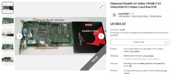

So I ordered a Diamond Vision Video Card off eBay to go in this bad boy. The draw for me was past experience and it had the drivers disk. While I am pretty sure I didn't have this model, I just remember buying a few Diamond cards over the years. The price and features were appealing at that time.
So Okay, criticize me for paying that much! If I don't like it I will put it right back up on eBay.
