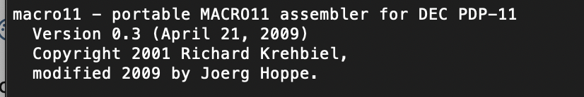

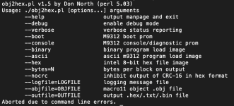

The C source code for a MACRO-11 cross-assembler is available online, as is a perl script to convert the object file output from the assembler into a HEX file.
The macro11 tool I use advertises itself as:
And the obj2hex.pl script as:
This gets a lot of the MACRO-11 source debugged on my iMac (other Operating Systems are available) before I ever go anywhere SIMH or a real PDP-11. And you can use your favourite text editor.
I have noticed one 'bug' with the assembler though, it does not like the source line"JMP @(R0)+", even though this is valid. I will look into this someday and see if I can fix it.
It does help to get a lot of the syntax errors etc. sorted out though. You can then copy it to SIMH and use the assembler under (say) RT-11.
In fact, I have just written myself a very noddy DLV11-J ECHO program using the above cross assembler to test out my DLV11-J card later on in the week.
There is an updated version of macro11, I'm currently using the 0.8 revision.

from: https://github.com/Rhialto/macro11
It may have fixed your bug.
And my PDP-11 linker perl application is available here: https://github.com/AK6DN/obj2bin
These are the tools I use to assemble/link my diagnostic programs for PDP-11 into run-able binaries .BIC/.BIN usable with SIMH or for insertion into XXDP filesystem compatible TU58/RX02 disk images.
