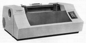

BTW, I used the parallel version of Centronics' early (if not first) dot matrix printer, the 101, with my PETs for many years, starting with my brand new chiclet 2001; a great printer, especially on its special stand and a box of paper underneath looking just like what the big boys at IBM were using ;-)
A little noisy to be sure, so it sat in the basement while my office was upstairs; don't let them tell you 10 feet is the maximum cable length, mine was at least 40 feet long (it's still around somewhere, I'll have to measure it... )
