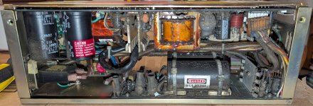

Hi there.
I recently acquired a MicroPDP-11/73 in a BA23-A box, however, most of the H7864 power supply, the two fans, and some of the logic boards were quite dirty with some black powdery gunk having been built up inside the BA23 -- especially inside the power supply. See the two attached photos.
Granted, I need to replace the RIFA capacitors in either case, so I need to open up the power supply regardless, but before proceeding, I am a little hesitant how to go about and clean up this buildup. I have started using some cotton-swabs (q-tips) and isopropyl alcohol, and even though it captures some of the gunk, it also kind of "smears" it along the PCB and component surfaces.
I am sure there are better ways to clean up this gunk, and I would appreciate any suggestions you might have.
Thanks!
Jörgen

Welcome to the forum @jorgen !
The black powder might just be dust, adhered over time with moisture and attracted via static electricity. Have you tried high-pressure air, maybe from a compressor?
- Alex
I would try and hoover out as much of that gunk as you can - undo all the connectors to get the ends of the cables free - then a combination of wet-wipes, foam cleaner and iso will eventually get the clear plastic clean and not sticky - finish with the iso to help it dry out... use cotton buds or a screw driver carefully to get in the gaps..
If you're changing the fans, they need to be proper high airflow ones - not PC cooler fans - the CPU and other boards REQUIRE good cooling all the time!
Yeah, that stuff is nasty. I've had a couple that I worked on 2 years ago. Basically did what you are doing. Though I started with disassembling it into the 3 main boards and disconnecting all the cables. Then using my air compressor to blow the worst of the stuff off - which still left a lot of gunk behind. Then a combination of paper towels, q-tips, a toothbrush and IPA (not the beer!) until it was clean. It was not a short session - at least 2 hours for each P/S.

It could be dust, but it's very black and is weirdly built-up closer to the fans, which I also find a bit odd. The fans are exhaust fans I believe? This makes me think that the grime has been collected in storage (in a garage, or shop perhaps?), and settled from "above". If the fans were running, I would have expected the dust closest to the fans to have been blown out of the case, and not collected that close to the exhaust. Seems weird, no?
I did use a vacuum on the BA23 once the power supply, logic boards, floppy and hard drive were removed which was pretty effective. It does "gunk" up the vacuum a bit, and it's a lot more of this gunk in the power supply, so I am a little hesitant to use the vacuum on it.
A compressor is a good idea, though I don't own one, but I think I will order a couple of compressed air cans ("electronics cleaner" ?!?) from Staples to see if I can blow off the worst of it, before proceeding with IPA and q-tips.

Based on your combined recommendations, I gather I will proceed by: disassembling the power supply, separate the three logic boards, disconnect all cables. Use compressed air to clean the most of the gunk off of all three PCBs, cables, connectors and housing; and then proceed with paper towels, q tips, IPA.
@Radix you mentioned foam cleaner and wet wipes for the cables. Are there any particular brand or kind that I should be looking for? I assume too aggressive of a foam cleaner might damage the plastic?

Foam cleaner is very gentle - but to varying degrees, wet - but it cleans well - you will need lots of cloth or wet wipes - really LOTS - then let it dry out completely... I reform the main caps in those in circuit, gradually running them up to about 150V over some hours - BE CAREFUL - DANGEROUS!! - with an adjustable supply via a limiting resistor. If you go too high, the switcher will start, which is not what you want. Then I run them on mains via a 100W bulb (in the UK) and let the switcher kick in repeatedly with little load for a while to exercise the output caps as well.

Hi everyone! I am sorry for the long delay, but figured I would give a status update on my restoration of my MicroPDP-11/73, after all of your super helpful tips and pointers.
I am not sure what the black "gunk" was that was all over the inside, and in retrospect trying to clean it out with IPA and swabs was not the greatest idea. I liked the idea of a compressor, but due to lack of space, I ended up buying an electric (plug-in) blower -- a small hand-hold 90CFM pretty powerful thing. The blower blasted most of the gunk out of the way.
I ended up separating the three boards in the power-supply (H7864A), replacing the three RIFA capacitors, some of which had visible cracks in the plastic casing. I ended up tracing out and drawing the schematics for the ac/dc PCB with the large caps. Happy to share if anyone is interested?

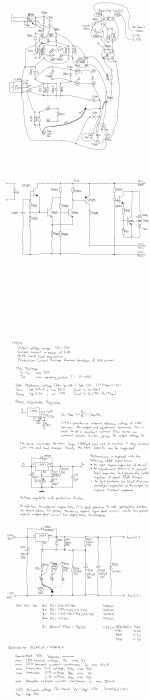

That's a good process there! - If you have made sense of the adjustable fan regulator part of that board, I would love to see your drawing - I change the 3 series resistors to 6K8 to get about 7 - 12V adjustment with the existing link and with new 185cfm fans, this works well...

Sure thing. I am attaching one of my notebook pages, that includes my cleaned up schematics of the adjustable fan regulator towards the bottom of the page. I meant to create a KiCad schematics, but have not gotten around to it yet.
Jörgen
Hi Jorgen - That is great work, thanks! - the presence of the -15V supply just for the fans was a surprise when I found it - in the later DEC version of the supply (The -B version) they use 2 x LM337T, one per fan but with common adjustment, and the -ve rail is regulated, with fan +ve going directly to ground, the opposite to here with the +ve LM317 regulator...
I was thinking of creating a Repair thread for the -B version where we could collate info like this - Maybe good to have a thread for each version, especially if you have found any good faults?

I can't say I have found real faults. Some oddities perhaps, like the orange/white wires for the remote control seems to be switched in the panel-mounted connector, compared to the connector on the PCB (i.e. white -> orange; orange -> white), but that could just have been someone having done work on the PSU previously, and in either case, it shouldn't matter since there is no polarity that you need to pay attention to in the remote power connector, as far as I know.
