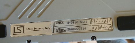

I purchased a Hunter 16 about 1 week ago, my very first Husky PC to own. Very impressed with its overall construction, very rugged.
My particular one has a model number of H-3610-5611, and serial number 3600007314
The main C drive is 1M/b in size total, and has an additional D drive with 256K of memory, appears a Flash RAM chip has been added on the main board by Logic Systems Inc. (plugged into a socket).

I will post a few photos of my unit in a little while.
