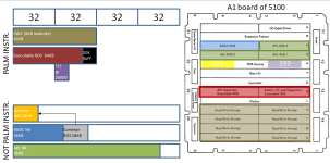

Let's take a look. Here is how I think the arrangement should be:
NOTE the IBM 5100 has a "mainboard" (A1) with "expansion slots" - but they're not exactly interchangeable. It's not an ISA bus. The slots are specific purpose - they are modular in that you can remove memory, or maybe remove just BASIC. But the overall arrangement is fairly rigid. And aside from the memory being at the "end", the arrangement is fairly different than the 5110. So as some highlights:
- APL Supervisor? (is that called APL ROS in the 5110?)
- Where is the Common ROS? Slot E is ROS Control, but Slot H also indicates some aspect of "BASIC" in there.
- for the Executable ROS, there is *something* different at the halfway (32KB) mark. And the last 20K (B000-FFFF) is all 0xFF values.
- as extracted, the BASIC NX and Common ROS were apparently across a seamless set of addresses (i.e. the resulting binary was 36+18 = 54KB in length), so should the Common ROS be addressed as such? Which then implies it is part of Slot C (and not E or H!)
- Previously I said I had reason to believe that the ROS (non-NX) PALM code was limited to 32K. So if that's the case, how is the 5100 executive ROS a total of 64K? It could be that the Executive ROS for the 5100 is really two separate portions of ROS's? Or I'm just wrong about that - but note the Executive ROS portion of my 5100 emulator is working (and it has the >>1 bit shift when addressing the executive ROS; if I remove that shift, the whole thing blows up and doesn't work - at least for BUP and initial startup, right on up to the language ROS handoff)
So now it's finding where the APL ROS and BASIC ROS equivalent are addressed from (which might be in the Executive ROS itself?), or what the APL Supervisor is all about. Also note that the BASIC NX and APL NX are quite a bit smaller than the 5110 versions -- I know for BASIC NX on the 5110, they added quite a bit of "FORM" keyword capability. I'm not sure on the APL capability differences (I suppose one obvious addition in the disk drive support -- which, did they basically use the same "file" format on tape or disk? you have to guess how much size you want to mark for a file -- kind of like guessing allocation-units on modern FAT drives?? just difference is with the disk, you don't have to issue a REWIND...).
I'm not sure what the "Expansion Feature" of the 5100 was (Slot B) -- I'd assume serial or modem related, some kind of comm. But the 5100 was light on external I/O and didn't have the Features ROS (no disk support). Whatever ROS it was, we don't have that yet.
Was the 5100 ever offered WITHOUT BASIC ? (i.e. did it have A/B/C variants like the 5110?)
I'll plug away at some trial and error. But I'm curious if anyone has insights or suggestions here :)

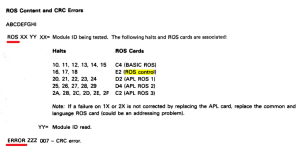

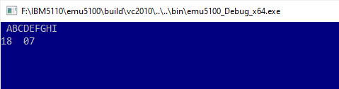

The meaning of this error code (according to the MIM page you referenced) is that the computer wanted to read ROS module 18 but encountered what it thinks is ROS module 07 instead.
ROS modules are 6144-byte ($1800-byte in hex) chunks of data in the non-executable ROS. Each one is identified by a number --- that's the number that shows up on the second line of the display when the 5100 is undergoing its "I" test.
ROS module 18 does exist in the data that I dumped --- and it passes the 5100's CRC verification. I don't think there is still unrecovered ROS data in the machine.*
What all this tells me is that the combo of the 5100 executable ROS and the emulator are looking for module 18 in a different part of memory than where your work-in-progress code is placing it now. Wherever the ROS+emulator is looking to find module 18, it's instead finding some other data in memory that has a "07" value in the place where the module identifier goes. You'll probably need to put the data for module 18 in that location, wherever it is.
There is no such thing as a module "07" in the 5100 non-executable ROS. However, I think you can find the module 18 data in the last 6144 bytes of the file binary_BCom.bin.

Ah, YY = Module ID *read*. The "007" below that distracted me (where ZZZ meant it should be 3-digits, not 2). (do later models of the 5100 show the actual letters "ROS" before the numbers? the 5110 does this; the MIM was updated in 1979, and I recall reading somewhere both the 5100/5110 weren't discontinued until '81 ? i.e. not sure if the executive ROS of early 5100's differed from later 5100's)

But for the main ROS's - the arrangement seems to be:
(it's just whats the relative address of each of these - they all start at 0? or are accessed as a continuation of another ROS's address space? )
BASIC ROS = 32K (the binary binary_BCom.bin is 54K - subtract 18K for common, that's 36K -- so there's 4K of "something" still in this ROS binary)
Executive ROS = 16K + 16K (should be 32K, so the exeros.bin has 32K of "something" - must be the APL Supervisor stuff, not sure how that upper 32K is addressed {unless it's 0-offset from "something")
APL ROS 1/2/3 = 32K + 32K + 32K = 96K total (that's consistent with the APL_LROS.bin that is 96K)
ROS Control = 18K (manual says this is somehow addressed "as part of" the BASIC ROS)

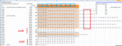

I noticed in the binary_BCom.bin the *first* 18K has a clear cut right around that offset (i.e. I thought maybe the CommonROS was the last 18K of that 54K file, maybe it's actually the first 18K?)
Right now I'm just trying to get the BASIC ROS up and going. But down the road, for the APL ROS - I wonder which one is "first" (ROS3? or does it go ROS1/2/3). From the controller perspective, it should be a seamless 0 to 96K address, but it might matter in the order of the binary file. TBD.
Agreed that first 32K of the executive ROS is solid and confirmed. And I suspect the reason I can't "interact" with it (type stuff) is that fires off interrupt 3, and part of that handling might either be in the ROS Control or the Common ROS (which I don't have sorted out yet) - I could be wrong about that, since somewhere in the MIM it says executive ROS $5B00 is the interrupt 3 handler (but in there it has some CTRL opcodes that may involve that ROS Controller?)

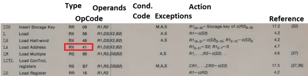

@larryw Yeah, I didn't want to full up learn System/370 :) And yes, assembly is subjective (in that it is up to the assembler software to decide what the mnemonics are).
Section 1.3: "Since the IBM System/360 was announced in 1964, there have been many different models. System/370 models had some improved capabilities, and some of these were the first IBM computers to implement virtual storage.... there is a set of 16 general-purpose registers, each one word (4 bytes) long... Their addresses are 0 to 15 Still another set of four registers is used in floating-point arithmetic.... In models newer than System/360, there is a set of 16 control registers... These registers are used almost exclusively by the operating system"
"Addresses in System/370 are usually 24-bit numbers, though in some modes in newer models 31-bit addresses can be used." (goes on to explain byte order, each address is a word of 32-bit, and the 88 characters of EBCDIC, followed by "zoned decimal" as related to punch cards).
And thought you might appreciate this from the Appendix C (that's nuts! Appendix C is also used in the IBM 5100 MIM manual for its OpCodes -- a completely different reference -- was that an industry insiders convention, to have appendix C be for opcodes? haha):
The book reader I have doesn't let me rotate the pages, so it's a pin of a pain to examine these. But Im really curious what tools they used to make these diagrams back in 1969. Like one of these, how would it have been expressed and sent to a printer back in those days? Some software on a System/360 itself?
There are many parallels to the PALM processor here -- it has 16 registers, each of 16-bit, and they start from address 0. And I noticed R1 (register 1) is often used as an index/offset from R0 (like R0 is a base address, and R1 used to jump around relative to that base)

So, these are notes/ramblings just for future prosperity :) I've examined each of the 5100 ROS's available, and see some interesting trends. I'll start with the Executive ROS:
For each of these, I basically scanned through them in a hex editor, and itemized out sections that were separated by at least 10-30 blanks (0x00).

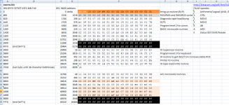

The PALM (Executive ROS) one is fairly straightforward...
1) the machine starts at whatever offset the first byte says. "00 04" in this case means start at the 00 01 02 03 04th offset, which is "1F FF" in this case (a CTRL $F,$FF instruction that "resets everything" {all the devices}). And things proceed from there
2) the MIM manual has a page that gives a sort of "memory map" of the Executive ROS - and the addresses I found line up with that (see descriptions in Column F).
3) at $3000 and $B000 are a bunch of 0xFF, I'm not sure why. The first one is 8K in length, the second one is 20K in length. They don't hurt or mask anything, it's just how the ROS was setup. Maybe it helped to clearly indicate "space available for future ROS expansions", as opposed to having 0x00 zeros.
4) The Executive ROS (Card 2x16KBx18 bits, 2 bits for parity). So each address is 2-bytes, which should explain why it is 64KB bytes total. (contrast to the ROS Control E2 card, that is 18Kx8-bit, which I'm still not exactly sure where that is located or how it is addressed - yet).

So when exploring binary-as-instructions, it's hard to know what is Data and what is Instruction. Like in the earlier PALM example, the first two bytes are actually Data (what offset to start at).
Anyway, if I assume this "BASIC_COM.bin" binary is System/3 opcodes (as viewed in the hex editor, and not having to byte swap anything -- Intel systems have to byte swap in memory, but the file as streamed should be ok)...... That binary file starts with "16" which actually is a valid System/3 opcode: "AZ". But the weird thing is, the entire first 512 bytes of this binary is full of "1x YY" instructions (see blue boxes below for the first 8 - but all 255 of them seem to be valid "1x" instructions). So maybe it's just initializing stuff - the first nibble ("0001") sets the address/indexing mode, the second nibble decides the action.
At offset 0x0200 (not shown) then you have a bunch of 0xF0 instructions (about 25 of them). I'm not System/3 expert, but it looks like "F0" is a halt instruction, followed by two operands that basically control what letters show up on some status LED of System/3 (what operands map to what letters are listed out in the manual). There are two operands since it is a LEFT and RIGHT set of segmented LEDs. So maybe it doesn't really halt but cycles through a bunch of letters?
So then the first "real instruction" isn't until 0x233, which is 0xCE... which, according to the little System/3 opcode chart -- is an invalid opcode :( Sad. So maybe I'm wrong, maybe all the stuff at these early addresses is actually data, cross-reference tables. But if it is code, then it starts at 0x233 and goes up for about 6K. Then something interesting happens.. a pattern!
@stepleton There is where I may need your help, you mentioned 1800h earlier (something I wasn't aware of till I dug into this binary)... well... see below
Starting at 0x17FC, I see this pattern of a 4-byte "code" followed by 6K of "instruction." And there is a pattern to the code:
00 10
00 11
00 12
..13, 14, 15, ...
01 16
01 17
I'm not sure if the two bytes after these codes is CRC values? Well, the section at the beginning is also 6K -- but there is no "00 09" or "00 01" or "00 00" marker, so where is the CRC code for that starting section?
Ok, but here's another interesting thing: all these 6K sections (except the first section @ 0x0000 and the last section 17 @ C000), they all contain that "F0" instruction.
Each section has a different number of F0 instructions -- and again, the manual suggest these are a HALT instruction (as in, go into an infinite loop), but also does talk about updating a LEFT/RIGHT LED display with the operand code (maybe it doesn't halt, or maybe these are branch targets in case some error conditions are encountered?).
Anyway, if I assume these are either branch targets, data, or just flicker the LEDs in a sequence -- if I skip the "F0" instructions, column G list the "code" that follows that sections F0 sequence. Each of the F0 entries are followed by two bytes. Then the end of the entire sequence is followed by "00 00". It could be System/3 by default "ignores" invalid OpCodes and just keeps incrementing the program counter? Not sure, which means from Column G I'm not sure what is exactly the first instruction executed. (e.g. "05" seems like an invalid instruction in the System/3 manual reference I have, but maybe it is a different model/etc).

1) is this BASIC_COM.bin file entirely System/3 instructions? (or is any portion of it actually table-data stuff? but it looks like 9x6K sections of something = 54K total)
2) where is the 18K of "ROS Control" content? (maybe there is no ROS Control, maybe it is just a buffer to funnel up to 18K between PALM and these emulated systems? don't think so, it is called "Control"... manual calls it as a "common and language ROS")
3) was System/3 byte, 2-byte, or word (4-byte) addressable? I'm still not 100% clear on that. It matters in trying to explain why the file is 54K (BASIC ROS is given 32K). If it is 2-byte addressed, then ok it's only 27K addresses and fits. [whatever it is, i'm not sure why it would be different on the IBM 5110 -- i.e. that the emulator is running for the 5110 ok]

And for completeness, here is an examination of the 96K APL binary (which should System/370 code).
The registers are word (32-bit). I'm not 100% sure if the addressing is also 32-bit - although I think it makes sense, as it explains how the APL ROS binary can be 96K (even though the APL ROS cards only have 32K -- well if each address can hold up to 4 bytes, they only needed 3 sections to hold up to 96K).
Nothing too exciting, things look like valid opcodes. The two exceptions are in RED below at 0x2FFC and towards the very end is a bunch of "83 6E" repeated starting at 0x17DFC. I'd assume those two sections are data tables of some sort (address offsets, ASCII/scancode conversions, etc?). But the repeat "83 6E" is curious, does that ring a bell with anyone in the context of System/370 ?
Then at 0xCE68 is something odd, a bunch of "0x80" repeated. Not sure what's going on there. (0x80 is also a valid opcode for that system, just not sure why it is repeated about 50 times).
But things like "50", "41", "05" ,"90", "91", "58", "5A", etc... all valid opcodes.
Again, I was marking any address that was preceded with about 10-30 null (0x00) characters. Typically, that represents major "breaks" between sections of instructions.
I was looking for "transitions" at the 32K and 64K mark, to see if anything was suspect about the ordering of of these sections -- the IBM 5100 slots are ROS 1 (D2) ROS 2 (D4) ROS 3 (C2). It doesn't really matter which sections (addresses) corresponds to which physical slot, just a curiosity.
But as stepleton mentioned about colors, it is interesting to get kind of 3 different "cultures" of instruction-code observed here, between PALM, System/3, and System/370.

I think there is another ROS besides #$04 and #$08. This is what I found on my 5110, trying all values in that instruction from #$00 to #$FF (I forget the exact number, but I think a number corresponded to the Feature ROS/Disk Sorting of the 5110 -- I'm suspecting for the 5100, some other number besides #$04 and #$08 will get a new sequence of code that might be the ROS Controller)
