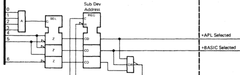

that means that the bus driver on the bottom right is disabled, so the executable ROS can't drive the bus.
AH, WAIT! I'm wrong. I just remembered that IBM numbers bits backwards. Go back to page 272, note that the SELector at top centre can only hear bits 6 ($02), 5 ($04) and 4 ($08). That means an address of $02 enables "+Dev Adr 1 Gated" with "+APL Selected" and "+BASIC Selected" disabled. (The other bits go into the selector gate, meaning addresses $0F and higher are ignored.)
What that's for I'm not sure about, but I bet the answer lies on page 273. I may come back to it later. I still like my hypothesis of this being a reset of some kind. Maybe it could allow you to set the address counter without actually causing the ROS storage cards to try and look up the address you're setting?

Having spent time looking at the logic diagrams in the 5100 MIM for a while, here's some observations.
On the 5110, the Common and Language ROS card includes the Common and BASIC ROS but not APL, that's on a separate card. You can see this on the System Logic Manual PDF page 4. There, you can also find the mechanism that makes ROS CTRL instructions with arguments $02, $04, $08 (bits 6, 5, and 4) pick Common, APL, or BASIC:
Eventually those bits gate whether APL, Basic, or Common ROS data goes out on the data bus. This is at bottom left:
I can't fully explain why there's "APL ROS Space" on the Common and Language ROS Card plus a second card dedicated to the APL ROS, but that's a mystery for another time.
Let's now look at the 5100's ROS Control Card logic on PDF page 272 of the MIM. Here's the logic that is controlled by the CTRL values $08/bit 4 (APL), $04/bit 5 (BASIC), and $02/bit 6 (nothing? --- note that unlike the 5110, there's no "Selected" line that comes out from the register).
Now go to the next page (still the ROS Control Card) and this part here:
Like in the 5110's Common and Language ROS Card, the 5100's Language ROS Card has ROS on it: an 18K ROS. Already that's a surprise, as we had thought that all the non-executable ROS was on separate cards, and the 5100 ROS Control Card was only for controlling the ROS, not for storing any data of its own!
But this ROS is strange. The circled 1 is a connection to the "enable" line that selects only bytes $7800 to $A800 of the BASIC ROS:
Even stranger: look up above and note that little box that says "OR DOT". That box denotes a "wired OR", which is a concept you'll remember us talking about for your keyboard project. In this case it simply means that anything that comes out of this memory just mixes with anything coming in over the bus from the executable ROS cards. Huh? Since this ROS is only active for BASIC ROS bytes $7800 to $A800, what can this be for?
I'm not sure what's going on here, but one theory perhaps is that we might have some kind of bank switching at work? As in, sometimes access to the $7800 to $A800 range accesses data on the BASIC ROS card, and other times it accesses data from this mystery ROS? The $02 argument to CTRL could determine this. Unfortunately, I can't yet see any mechanism that would cause the BASIC ROS and the mystery ROS to be accessed at different times. Perhaps if you study the logic diagrams, something might occur to you?
I'm just puzzled.
