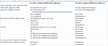

(recall that whole section around $5FXX is IO Supervisor related stuff; and also only the "CTRL $1,#$02" might be valid, the rest could be bogus/misleading {perhaps actually data instead} -- but doesn't hurt to try 'em all :D )
I think if you plug some of those into the sample machine code for extracting ROS, we'll get some different responses.
And yes, use of those values contradicts the 5100 MIM manual: (where only #$04 and #$08 should be defined)
I can't find a similar chart for the 5110's use of the CTRL opcode, but in Christian's notes:
"To extract another ROS alter the CTRL instruction at location 0B00, use #$08 for the BASIC ROS and #$02 for the Common ROS." (which is confusing/misleading since elsewhere in the manual, it does say BASIC and Common share the same address space).
Anyhow, that's the request: using Christian's sample to access ROS's, can anyone with a 5100 try plugging in #$02 (i.e. values besides #$04 and #$08) and see if a difference sequence of binary is copied to RWS? If so, that should be the missing ROS. I'm not sure it'll have 6K segments also, but it should be a total of about 18K.

And after a little digging, I came up with this Device Address chart between the 5100 and 5110:
What's interesting is how devices 0A/0B/0C/0D aren't described very much -- yet they aren't just listed as not-used. Must be the time machine interfaces :p Teasing, I'm sure they were "work in progress" prototype/experimental device addresses for the features that eventually got added in the 5110.
