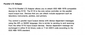

You're right about the IEEE-488 support, per the GeneralInfo and Planning manual: (on the Commodore systems, they had disk drives through the IEEE 488, so I was hoping something there could be retrofitted to the 5110 -- but seems we have to source or replicate these parallel I/O adapter cards)
Click image for larger version  Name:	488.jpg Views:	0 Size:	92.0 KB ID:	1224168

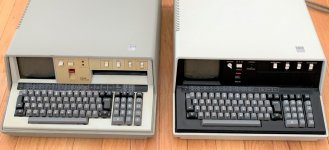

Just to add a bit more info, attached is a picture of a 5100 on the left and a 5110 on the right. Between the keyboard and screen are key labels for the upper row. On the right, there are two rows. One row is for APL and one is for BASIC. On the left are three rows. One for APL, one for BASIC and one for Communication (this one has the serial port). It's an easy way to see what functionality an IBM 51xx has. The dead giveaway is the forth toggle switch on the top right of the face next to the screen but the keyboard function label helps as well.

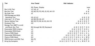

Do the letters at the startup of the 5110 correspond to the expansion slots? I assumed so, since the letter omit "i" (which is also omitted in the manuals).
But the manuals also only go up to N. So what is P?
And if you omit "i" then P is the 14th entry (even starting at 1 instead of 0). So then what is "ROS 15" ? (what's the 15th ROS?)
Maybe the ROS count "ROS 15" includes the "i"? Or some expansion slots hold two options instead of just 1, maybe the ROS index accounts for that.
And what is the "X2" and "X4" in the IBM manual A1 board diagram? I assume it's some bandwidth increase (x2 rate, x4 rate) between those components?
Then one more question: should I just remove the black "rubber" thing that is between the PALM processor and the BASE I/O card? It appears to just be some kind of spacer. Is it just a "stopper' to help keep the cards from coming out when hanging? I've seen this rubber-whatever-it-is deteriorate in other 5100s (maybe from storage outside of A/C rooms, from heat?) - mines rather ok, but there might be specs of some kind of growth started in it.
No relation. "I" is usually removed so people don't confuse it with "L" or "1" when reporting things. That's why "O" is not there either (confused with "0")
These are "bring up diagnostic" tests. As noted in the IBM 5110 MIM manual there is a table. The middle column tells you what position card is tested. The right column tells you what is on screen when that test has passed. There is more information about these tests in the manual.
That is Error number 015 in the ROS at the current test as indicated by the test letters showing at the top of the screen. You can usually find those error codes in the MAP manual and see what the issue/diagnosis is.
These denote the board jumpers between boards. The CPU board has two of them. I am guessing X2 and X4 denotes that the jumpers are different circuitry.
Thanks, I missed that in the MIM. Are the cards divided into 4 sections? Like "K4" is the 4th section of the K-slot? (like I see "M2 through N4", although I don't see an M1 listed)
Oh in this case, I don't think it's an error code. I mean, using Norbert's 5110 emulator as a reference, on power up the system cycles through ROS 1, 2, 3, 4, 5, ... "1B"... "41" (I didn't catch that it was hex until just now). And the letters at the top "grow" from ABCDEFGH to ABCDEFGHJKLMNOP (and then Q, as noted in your diagram - the "Q" goes very quick, would have to video it back in slow motion). So I think the ROS is normal startup stuff. I did have a fault show up once, and some error code I think showed up at the bottom of the screen - but I just did a reset and haven't seen the fault again since. I'll grab a shot of it it happens again, since I'm not sure if Norbert's emulator readily supports emulating faults (maybe the core engine can, just no ready interface to induce them).
There is another "X4" marked between A and B slots. There are 7 dots on the X4's and 5 dots on the X2's, maybe that corresponds to some number of pins. Can check next weekend.
