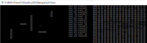

Incorporated pdcurses into the project to make it easier to show multiple-windows of things at the same time.
The "display" on the left, the keyboard parsing scrolls in the middle, and added a hex-memory dump on the right. I'll add color later to better highlight these separate areas.
It's more fun to see it "live" so I'll upload a video of that:
Next thing: since the first "register" is the program counter, maybe I could add an "on the fly" disassembler. Then add a software version of the "STEP SWITCH" so we could go instruction by instruction to see the effects.
But this is helping to get a better understanding of how the different levels swap between RWS and ROS's (see the sample below, the level 0 program counter register is at "0BDC" (DC 0B at the start of the dump), which is precisely in the region of the sample program (that started at 0x0B00). The "hex dump" here isn't replicating the hardware-switch on the IBM5100 - which that one has a funky what of showing the 16-bit register values: it shows them vertically, which is a good way to save horizontal screen space, but makes it harder for me to decipher them on the fly. So the emulator helps present that in a more natural way (IMO).

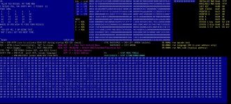

Well, looks like this became my Spring Break project for 2022 :) Couldn't help it, made it interactive and can single cycle step clear from the beginning of BUP (startup).
Christian included several BASIC samples with this EMU package - none of them actually work on the IBM 5100. But the easiest one to adapt that I found was the one called salvo1.bas (a Sink-my-Battleship type of game, where the computer does make random guesses to sink your own). Some limitations of IBM 5110 BASIC: (1) no ! (exclamation mark) - it has "?" but not "!", mostly an issue just for print strings that contain "!" or ' apostrophes, (2) multiple BASIC statements can't be compounded using ":" colon, (3) lines can be over 64 columns, (4) the 5110 does have RND(n) to init a random seed, but to get a RND value use "RND" itself (no parans) assigned to a variable.
Pretty neat that his modified version of salvo1.bas is actually playable now, on the 5110 (and probably the 5100) :D
Lots of interesting things observed - (1) like at the end of each BASIC statement that is executed, the system switches back to EXECUTIVE ROS (which makes sense - to handle things like scrolling the screen, monitor for ATTN to suspend the run and resume it with "GO"). (2) To reach the bootup blinking cursor prompt takes about 2 million CPU cycles, (3) the BUP sequence is about 170,000 CPU cycles before the ROS's start getting initialized and checked, (4) it takes ~10,000 instructions just to blink the cursor!!
it's all functional, including even the tape support (Christian included a sample CSF in both DSK and TAP formats). Christian also included a PALM disassembler .c in his EMU source - that compiles very easily. With that, I might be able to offer an "on-the-fly" PALM OP disassembler right in the emulator. I wrote a MIPS emulator decades ago, and my C is still quite rusty -- we'll see. But at least I think there is enough here to help me figure out the ROS CRC stuff now :D
I'll get this branch going in git eventually - some code cleanup to do first. And I tried to make it work with the 5100 ROS - conceptually the piece parts are there (as far as PALM opcode support), but it's going to take a bit more work to sort out.
