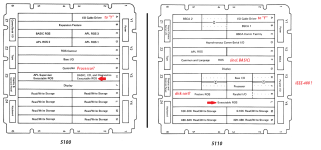

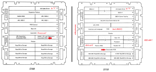

For my own context, and for those who may be passing by in the future...
Here is a comparison of the A1 boards and ROS arrangements between the systems. I think the 5100 "RWS" (RAM) were in 8K cards, while the 5110 had 1 less RWS slot, but used 16K cards.

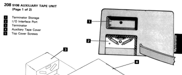

Tapes
You are correct that the tape drive is not like a cassette-tape deck (although SCAMP, the experimental machine that lead to the 5100 series, did use an ordinary tape recorder.) The tapes are cartridges about the size of three decks of cards laid side-by-side. The tape mechanism can and does go back and forth over the tape as it reads and writes. Here is a video of the tape mechanism in my 5100 at work loading an APL workspace:
(The loud fan noise is from the apparatus I use to convert power from 50 Hz 230 VAC to 60 Hz 120 VAC; my thumb is on the tape because the cartridge positioning/guide rollers inside the tape drive need servicing, and until they get it I need to hold the tape against the heads and capstan manually.)
Most systems that used tapes like this would have you "partition" (not the word they used) the tape into a series of "chunks" (also not the word they used), a bit like chapters in a book. In some cases you would read the entire chunk into memory, do some work, and then write the whole chunk back onto tape. (This is how APL workspaces worked.) In other cases you would read and write smaller records within a chunk. When you're loading a whole chunk, you usually just say which one you want to load: the computer then figures out where it is on the tape, rewinds or advances the tape to the chunk, then loads it.
You can find out more about tape usage in BASIC and APL by reading the IBM 5100 and 5110 manuals for both languages.

And, what's "BX" extended ROS? I didn't yet come across more details about that.
