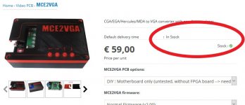

You mean THIS ONE?Screenshot 2020-12-08 132301 (2).jpg Looks like it's in stock. I HIGHLY recommend that. I've built and sold many of those from kits and have not received a single complaint. They work very well indeed. I've also dealt with Serdashop and have not had reason to complain. He seems like a straight shooter.

Yes is this, I think i will buy it.
what is the difference between Normal Firmware (V2.0) or Special Capture Firmware (VGA-COMON-RES) ?
Which one should i take ?

I have no experience with the "Special Capture Firmware (VGA-COMON-RES)". I have modified the original firmware though just to tweak it so that it would start up with settings preset so that it didnnt need to be adjusted for best picture based on my video card and monitor. I would be interested in trying both firmwares and decide which one works best for my own needs.
