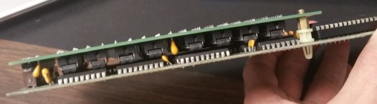

thanks to ab0tj for a great design! I went off reservation with my standoffs, just used some crap I had lying around so I didn't have to drill out the expansion PCB
notice how the expansion board has a tiny amount of bowing? might want to pull the standoff holes away from the pin header by just a fuzz, like a couple thou

Awesome! I'm glad to see it worked for you. I think I might need to rebuild mine but with the same header you used. Yours has much better fitment than mine.

I built one of these a few weeks ago. Worked perfectly first try!
The mounting holes are just a hair off, but my mounting screws still make it. I didn't make any adjustment to the layout. I don't have a bend issue with all the dram's sitting flush. The mounting holes are only a minor issue, so the board is perfectly usable, and I have extras here.
