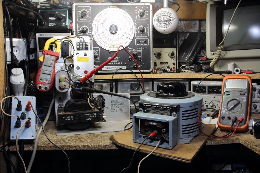

Power supply checkout finished today. They aren't rocket science. You got a switch, fuse, a transformer, two capacitors, a resistor and two diodes. Caps tested and reformed fine. All other components also tested fine. Powered up fine as well.
