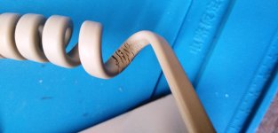

The keyboard cable has some cracks but only in one place nearest the monitor.
