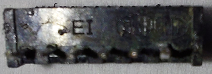

Main-board from a TEAC FD-55GFR. The two capacitors (C25 + C23) in the driver-circuit for the stepper that drives the head, are they non-polarized or just not labeled with clear polarization? (the silk-screening doesn't show any indication of polarization either)
Related question: Is the stepper driven by AC or DC? If the former, then I'd expect those capacitors to be non-polarized.
I'm working to repair some boards that got damp and these caps got corroded/lumpy.

Are they electrolytic? If so the polarization should be marked. Also, if they are electrolytic, there's a decent chance one side connects directly to the ground of the drive's supply. Not always, but that is one way to check. Or are they SMT ceramic? Those aren't polarized. No ceramic is.
If the stepper is driven by AC or DC is a trick question. It is driven by DC pulses, which may or may not change polarity depending on the configuration. Do you have a picture? I see VeryVon's picture but can't find C25.

Yes, electrolytic. Non-polarized electrolytics do exist. Polarization isn't marked unless BP stands for something.
(bi-polar? Would that equate to being non-polarized?) Already checked against ground, no direct connections.

I know there are non-polarized electrolytics, I have a few in my stash. I've seen "NP" for "no polarity", but BP....I don't know if there's a standard for that. Could be bi-polar as you said. Every electrolytic known to be polarized I have seen in the last few decades has been marked. So if there's no markings, it's fairly safe to say they are non-polarized.
Ok so the driver IC is a standard Darlington array. I wouldn't expect much help from the datasheet in that case, but it does give a clue about the outputs. You wouldn't want to put two polarized caps in parallel because one will always be reversed, and they don't like that, as you pointed out.
And I just decided to look for NP caps on Digikey and aha! BP is indeed marked for this purpose. I use so few NP caps I rarely run into this. Here's an example but I found others in my search results that also had the B.P. marking: https://www.digikey.com/en/products/detail/nichicon/UVP1C332MHD/2539561
You could use a diode on each polarized cap in parallel, but I'd avoid that. The voltage drop of the diode and some non-linearity could screw things up. Not to mention that you now have two capacitors masquerading as one, so that would be, uh, interesting. My advice is to get the correct replacement and save yourself headaches later.

Yeah, that clears that up then. They're non-polarized. I won't be trying a janky caps/diodes kludge.
Film caps, eh? I've got a number of those, I'll have to see if any are close enough in value. Probably have the room.
I'm assuming they're bad because one had a leg corroded entirely away and the other has holes corroded through the casing underneath the label.
But thanks for making sure I wasn't replacing things willy-nilly! One of these boards could use a dip in evaporust to clean the resistors and resistor-arrays, though I'm not sure whether it would eat the semi-corroded solder and make everything fall off the board...

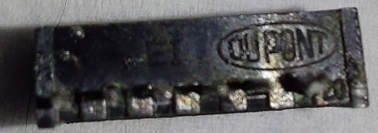

I've seen very old ceramic caps that look like that, in old radios. Yeah, they are nonpolarized. I would think if you can find a disc capacitor of the same value, it would fit nicely and work fine.
Right you are! I found a couple disc-caps of the right capacity, although being 1KV is a bit overkill, they should work.
Sadly, none of my film-caps were high enough capacity.
Here they are installed! Testing will have to wait until I have a computer that can interface with 5-1/4 drives operational, unless there are jumper-settings to make it run a self-check once it's installed in a stand-alone drive?

Aw nuts. Looks like I'd need ones labeled 685, instead! Well shoot, I don't think I have any suitable caps in my parts-drawers then. That sucks!
Still, thank you for pointing that out before I hooked this up to power. Dunno if it would hurt anything, but don't want to risk it.
Also, did you know TEAC floppy-drives had parts made by DuPont?
