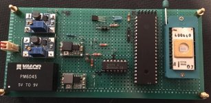

2716/08 "Promulator"
As I had mentioned, in order to develop the 4004/4040 boards I needed a "promulator" so that I wouldn't have to constantly "burn and learn" with UVEPROMS. Even the tedium of installing/removing a 28C16 EEPROM would be a PITA. So, here is my design, using a PIC 16F18877 40-pin DIP, and a IDT7132SA100P 2kx8 dual port RAM. I used this particular PIC because it has lots of ports, RAM, flash for code, is a DIP, and is fairly cheap to buy, use, and to program (no crystal is really needed). Communications are handled serially at 9600 via a USB serial adapter. Pictures and acreen shot of the menu is attached. I THINK that this will work with 2708's or '16's. Note that there is an external +5 power supply. You MIGHT be able to get away with having the target board power it but I didn't want to take that chance.
A much better programmer than I am could, I believe, substitute hardware for software here with basically no loss of functionality. This is a pretty fast chip (32 Mhz), and it might be possible to write interrupt-driven change of pins or change of CE/read code to present new data given the address, therefore, you wouldn't really need the dual-port RAM (somewhat rare, expensive, and no longer made) at all. The older UVEPROM chips had an access time of about 500 nsec; this is enough time for interupt overhead and a little code at a 32mhz clock. You might have to patch in some assembly to pull this off.
As it is, this is a two-chip design; but it would be pretty cool to get it down to one!
The code was in "free" version Microchip C with MPLAB X as the environment. A Pickit 3 was used for programming and debugging. I was not very happy with the action of the debugger but at this price who can complain. I'm thinking about getting an ICD3 which is on sale for a few more days now that the ICD4 is out. THAT is a much better debugger, and although I stink at C coding, I am a very determined debugger and can basically make anything work if I can debug it.
2708 (04?) Programmer
Although I've already built my 4040/4004 boards around 2716's, they REALLY would have been more period-accurate with 2708's. I had some 2708's, but no programmer for them. With code and I/O very similar to the promulator, I modified that using "control-c control-u" object oriented programming into a 2708 programmer, also shown. It seems to work fine. You may laugh at the power supply design, a USB wall wart going into FIVE (count them, five) DC-DC converters. Why?
One is for the +25 programming pulse for the 2708
One is for the +12 supply to the 2708
The +12 goes through another DC-DC converter to get down to +5 for the 2708,PIC, and 7407. USB power supplies can be a little off on the voltage and noisy, so I chose this route.
An isolated DC-DC converter (meant for Ethernet boards?) produces -9, which I bring down to -5 through ANOTHER DC-DC converter for the 2708.
I don't think that I paid more than 75 cents each for any of these items, and it was expedient. The regulation of the Chinese boards at "rated" loads is questionable according to others due to barely-adequate coils and capacitors. I might have been able to do without one of them but I didn't want to press it.
